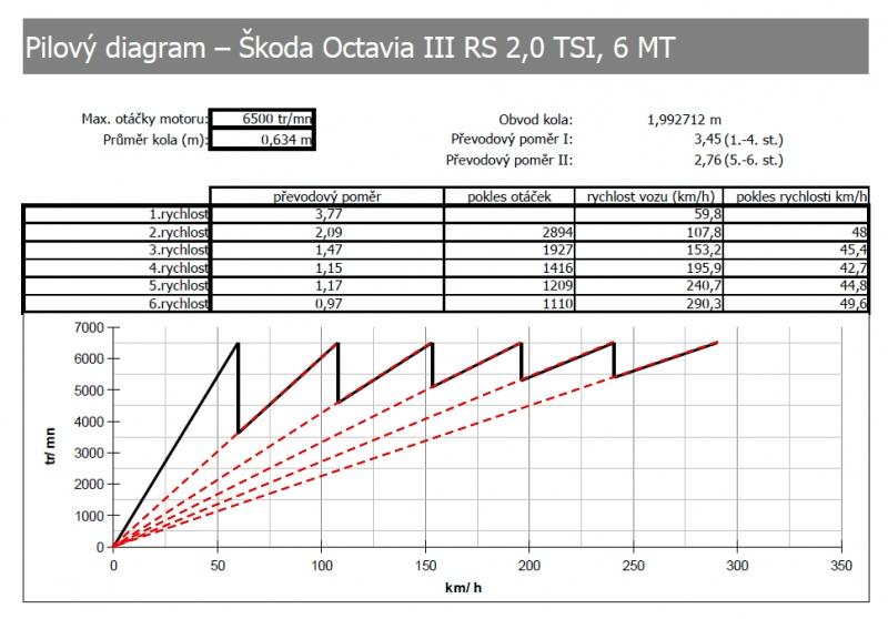

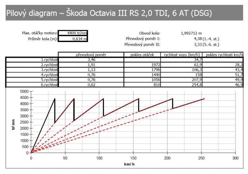

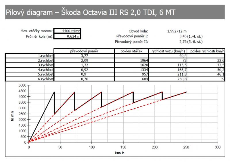

Here's the gear ratios, manual/DSG, petrol/diesel:
Nice graphs, useful info - thanks
Compared to my 2012 FL MkII vRS TDi DSG the new MkIII would appear to have the same gear ratios in 1st and 2nd but higher ratios in 3rd. 4th, 5th and 6th.  Would also appear to just about reach top speed in 5th (and 6th?).

Further to my earlier post - the posted chart states the max revs for the 2.0TDi vRS as 4400rpm whereas my 2012 vRS is red-lined at 5000rpm as are other VAG cars with the same '170' engine.  HAs the rev limit really been so reduced on the latest, more powerful, version of the engine?
No, it's not. You just don't get any mechanical benefit from the engine above 4400rpm, so it's basically pointless to rev past that point and you should engage the next gear. Turbo diesel engines behave differently from normally aspirated petrol engines, as you know.
You can spot in the graphs that all available gearboxes have quite tall 4th, 5th and 6th. This is only to help with economy. Also top speed is for 5th gear, 6th is just for motorway cruising (which I think is fine).
I agree that there is no point in revving the diesel vRS beyond 4400rpm, although in Sports mode on full throttle the DSG in my car takes the engine closer to the red-line.  Usually manufacturer's figures for max speed in the gears are quoted at max revs.  I think that Skoda's quoting max. useful max speed in the gears is better.
I would prefer the higher gearing of the MkIII in 4th, 5th and 6th (3rd is also higher) over the gearing in my car.
Full thottle on the vRS 2.0 TSI AT (DSG) would make the car change to 6th gear around ~280 km/h ???
How does these charts comply when you add windresistance ?
The chart is simply the theoretical speeds available in each gear.  Purely mechanical calculation of gearing x revs.   My 2012 vRS with DSG as a 6th gear ratio of 32mph/1000rpm so at 5000rpm would be doing 160mph.  However, wind resistance, etc. means it tops out at 139mph at 4350rpm (which is over the max power revs of 4200rpm so the car is over-geared slightly in top gear).
it appears that the MKIII vRS 2.0TSI DSG is over-geared in 6th AND 5th gear.
My point being exactly that you take the charts and then add your own assumptions :-)
