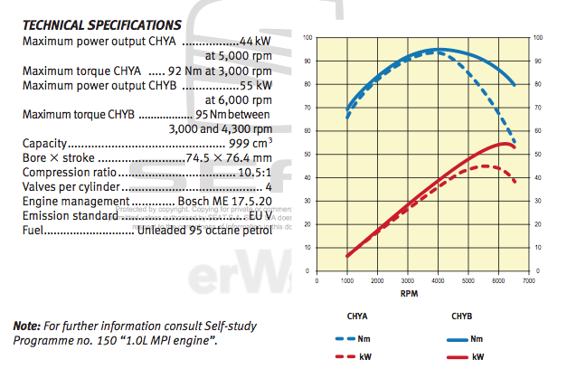

The "official" one, I think (from the Mii forum, possibly):
Edited by philhoward
In all honesty, I can't see me ever going over 4500 revs, not the way this little gearbox is matched. There really is no difference between the two below that.
Thanks for posting the graphs - interesting stuff.
