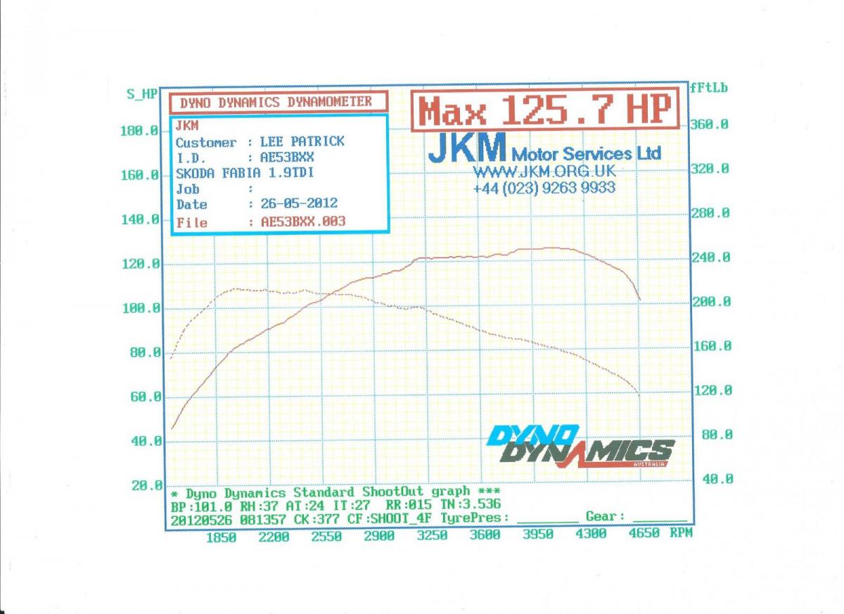

Got my 1.9TDi Fabia PD100, ran 125.7 and 220ft/lb unmodded at JKM's heartbreak rollers last year. My question is, would a remap get me much of a gain power/ torque wise? Clive, Ben et al, any ideas and a price would be nice ;)

I know Garry, 99.999% sure it's not mapped, previous owner had it in spot on or before it's service dates, it's just been well looked after mechanically. Even Jim at JKM was surprised when I told him it's not mapped! I have every last receipt the previous owner was billed for. It's just a 'quick' 1.9TDi mate. I did read that the ECU 'learns' your driving style so that may play a BIG part :bandit:  but the turbo is a stok KKK but it does spool up very nicely. I've never got to the bottom of what makes it, in essence, 25% above standard, mate.
here's me lovely curves :blush:
and boost logs

Unless JKM's rollers are very optimistic
There's another post on here about a Shark-mapped 2.0 CR Octavia running 210 on the JKM rollers against mine which ran 200.2 on Shark's own rollers
they are renowned as some of the most accurate though :)
