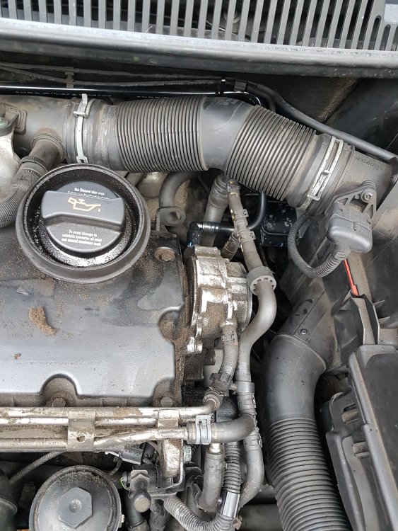

I had pretty much exactly the same problem on my polo, brakes binding when hot, pumping the pedal far as poss 3 times when stopped would release them but when braking slowing down they would bind again!!! So frustrating!!!
My car is a few years old now and has done 186k so i knew the brakes needed sorting!!
I had new front calipers, discs, pads, new flexi hoses and new calipers on the rear.....
Still the brakes were binding...
Had the abs pump changed, thought we'd cracked it then binding again!!!
Next step was to change the brake master cylinder to see if that would solve it, but after reading on here about servo and vacuum pumps briefly, I mentioned it to my mechanic....

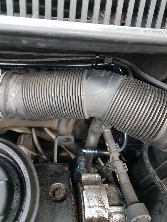

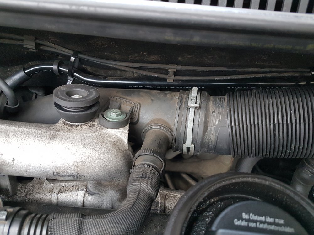

He has changed the pipe which goes from the servo to the vacuum pump and it has finally fixed it!!!
Apparently they have a one way valve in and when tested mine was sticking 9 times out of 10 causing the brakes to bind!!
Hope this helps some of you!!
It's the new shiny black pipe in the photos...
