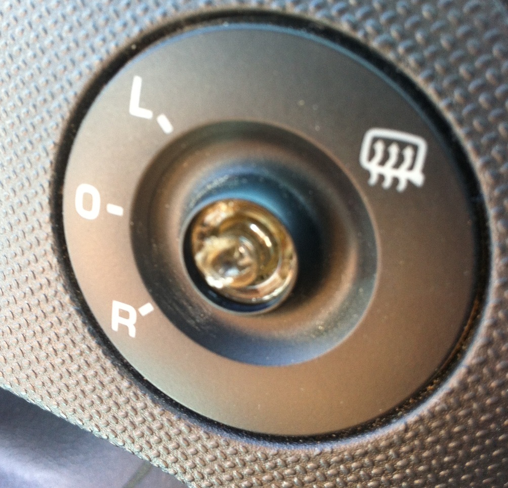

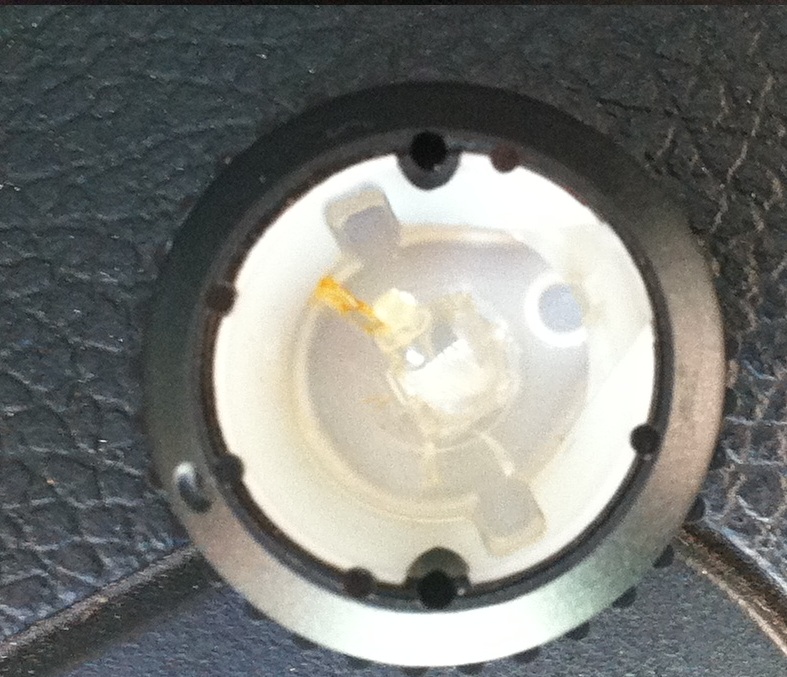

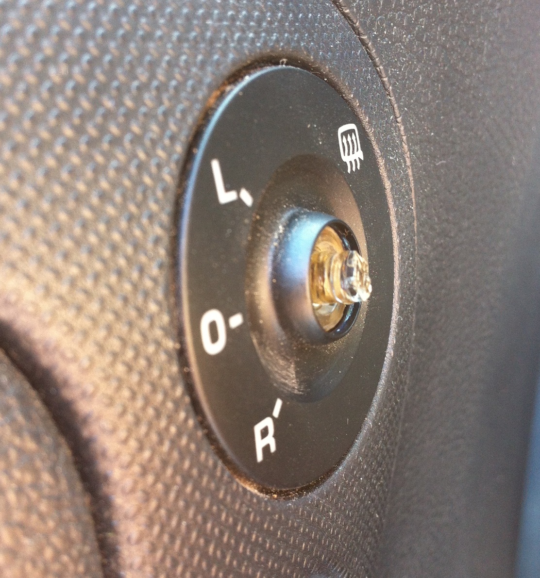

i have a prob: my mirror joystick is broken without any reasone or exaggerated force :(

Looks like the plastic cracked, so I wonder whether Skoda will do much beyond try to sell you their part.  For all they know, you may have caught it getting in the car and snapped it off.
As for left and right door - the component is the same surely?  It is only on one side of the car (the driver's side), whether that's left or right, so a UK joystick should fit your LHD car.

Does the small broken toggle still attached to the unit still work? If so can you super glue the joystick back on? Like you said if you are the only driver and don't move it often it may be cheaper to do that than pay £19.99
It does look like that unit would fit fine.

yes it's still work and it stuck on the left mirror... and it looks like the two parts will fit each other
i didn't thought on using a glue... good idea :)
what do you think about using Epoxy, it might be better?
I would use epoxy if you have it available.

The U.K. one is different in at the very least, the switch is reversed. Your left/right would be where our U.K. heater symbol is, your heater, where our left/right is!
I think therefor, you might possibly find that you will need to alter the wiring plug as you may make the mirrors left instead of righ when you try to move them! I could be wrong though and would like to know if you DO get a U.K. one, if it just goes straight on as I may get a European one... It looks as though it will make more sense having the heater symbol where it is easy to spot and the left/right will still be quite simple.

It's the same part, just installed in our right hand door.  It will fit your left hand door.
found out its a door panel removal job, as is a mirror removal... clever mr Skoda!
Another thing to think about... Whilst awaiting the part, at the correct price, how about just screwing a large headed self tapping screw into the remaining bit of switch, to use as the lever? Do it well and it will work well enough, just look horrid enough to get you to replace it soon as you find a new one.
