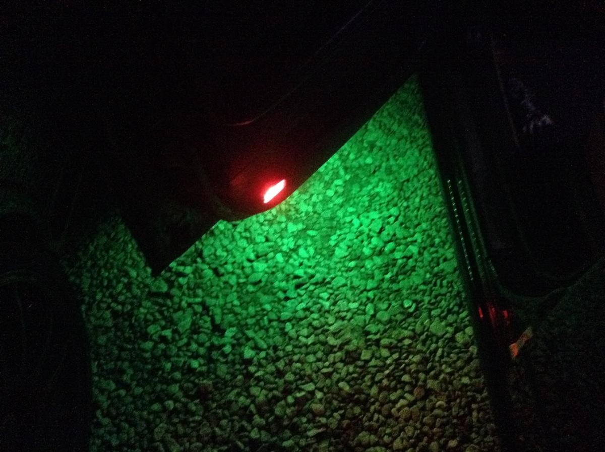

I fitted these to the Fabia...
Looks good and cost £2 off eBay...
Dead easy to fit,used the existing wires off the puddle light.
eBay item number..271286233889

Like the idea in swedey's pic; it's a great halfway measure, just a shame that you have to open the door to get them to work so stepping into a puddle is only avoidable if you're getting OUT of the car! Good work though. :)
