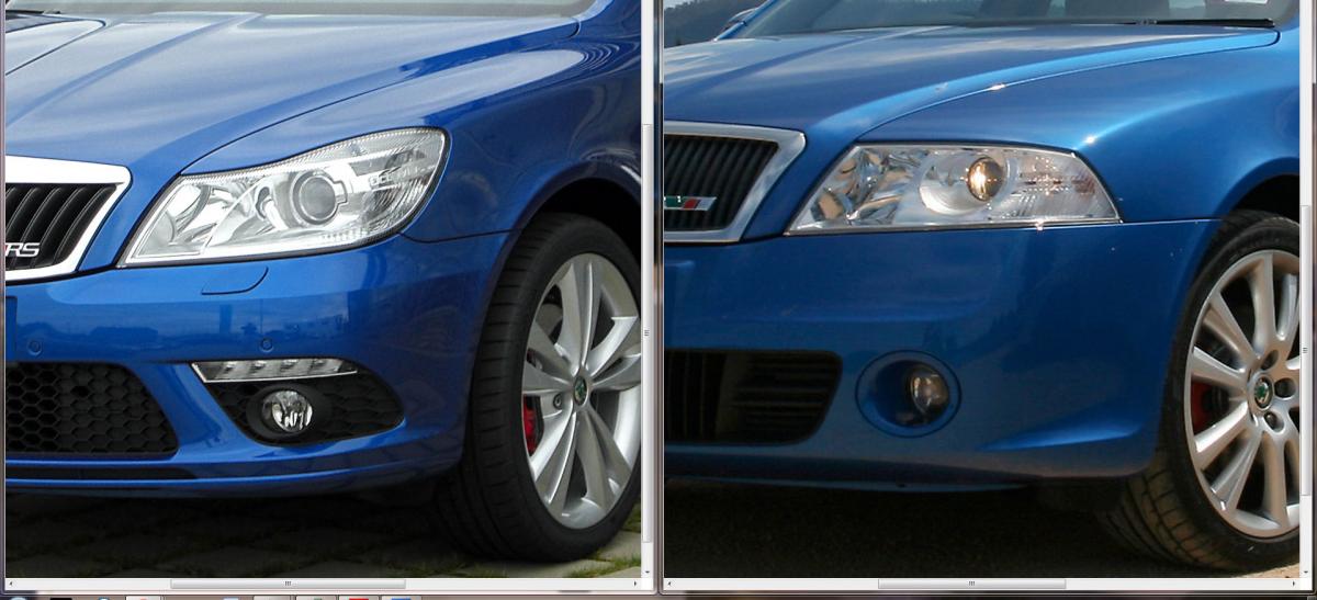

So... did some comparison and the modification would need to be around the "Flick" near to the lights.
I'm thinking that if i can pick up a cheap FL front under £40 shell i might have a look :)
I can get a complete FL front bumper for £350 :)
£350 is not bad if it truly includes all the parts. Bumper, grills, DRL's, fog lights, headlight washers, plastic supports inside the bumper that the DRL's and foglights are attached to. You then also have to built the wiring for the DRL's. And on top of that, you need new grill and it's surroundings to the bonnet. Pre-FL grill would look silly with FL bumper... :think:
Result is something like this:
