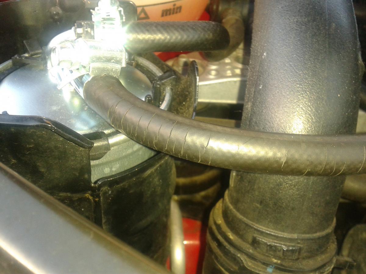

I have attached a photo showing the split fuel hose which goes from the fuel filter to the injectors. I cannot seem to find this part on eBay/online, does anyone know the part number, or is it really a trip to the stealers? Its a 2008 Fabia 1.4 TDI
Just buy some fuel hose and cut it to length. Doesn't have to be anything specific just get the right I.D.
