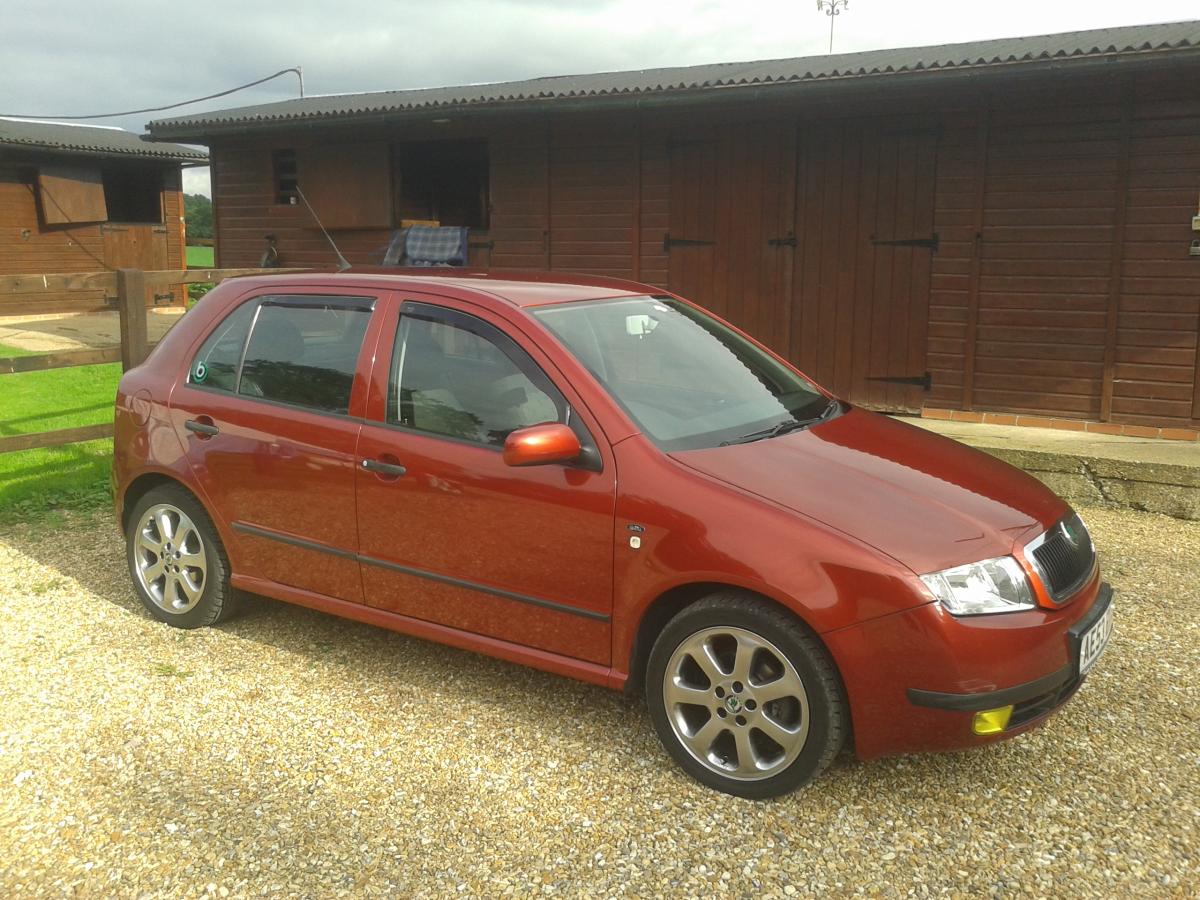

I love those L&K alloys :) That's why I put them on my Fabia :blush:
Wish they did them in 17" though.  They do look nice on a Fabia too.
I concurr :yes:  I think they were only 16s for the 55 sidewall.
That's a nice looking Fabia.
