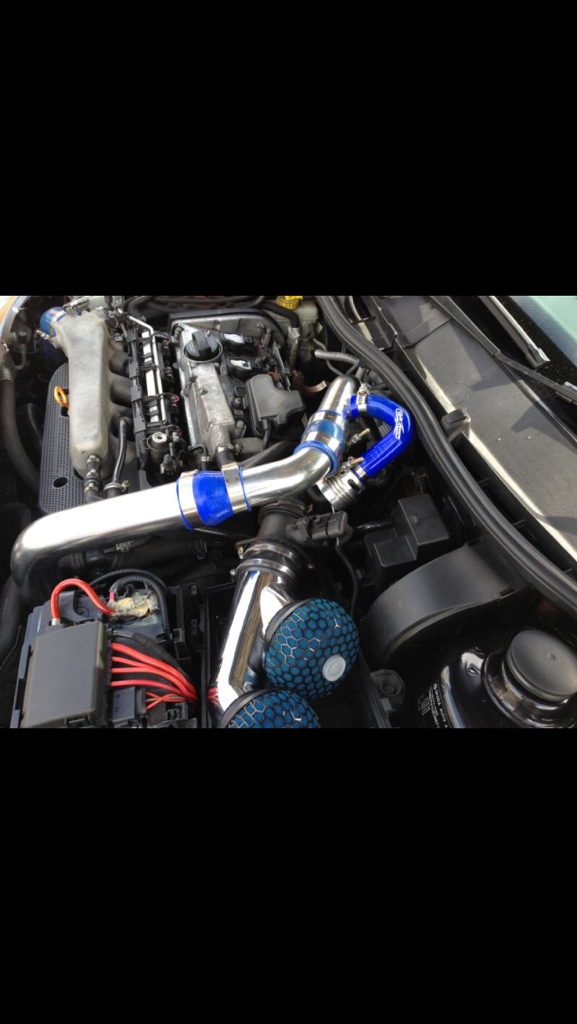

Right just need a bit of info on this the guy I got the car from says that the dv on the car is a forge one but I have been looking at forge 007 and 008 and they don't look like the one that's on it and I have been told that my car should really have 007 or 008 but wat I want to know is will the DV that's on my car damage the engine in anyway and if I do buy a forge one is it jut a matter of taking the old DV off and replacing it with a 007 or is there more To it than that? I have attached a pic of it so you can see for urselfs post-110147-0-17863800-1385228695_thumb.jpg
That looks like an atmospheric dv, similar to baileys. General concensus is that the 1.8t doesn't like any atmospheric dv so would better be removed. Standard recirc valve is fine but if you want to upgrade then the forge items you mentioned are very popular. I have a turbosmart dv on mine.

Nothing wrong with the OEM DV.
Ive had Forge 007's & Turbosmart DV's on Vag 1.8T's, & they do not improve peformance at all, but do offer more reliabilty. However an OEM DV is about £25 so you can buy 4 for the price of one Forge or Turbosmart. Unless you are planning on running big boost I can see no point of using anything other than the OEM DV.

So is it ok with the current DV on my car then and is it safe?.

Standard DV is the best one to use simple
Just be sure to use the latest version which is 710N, my car boost 1.5bar with stock DV and holds pressure without any problems.
I don't have the oem one just the current DV that's on the car reson I am asking is that ok to use and will it do damage? Also if I get a recirculating DV they don't make noise I quite like the sound of a DV or Turbo chatter so say I was to get a recirculating DV how could I get some noise cone filter maybe?

You get noise up thru a open cone
Forge do a hybrid valve which give abit of recirc and also has a vent
Look up a forge split r valve mate
Currently have a spliter valve fitted running at 1.3 bar no probs only a little dump to atmosphere I think it's sett 15 clicks back from full recirc. Works ok no EML on.
Currently have a spliter valve fitted running at 1.3 bar no probs only a little dump to atmosphere I think it's sett 15 clicks back from full recirc. Works ok no EML on. Gives a bit of waste gate dump noise but I'm led to believe these cars don't dump loud like a subaru or mitsubishi.

It is not the car doing that noise but the DV so you could make these cars dump loud like the scoobys and evo's but they are not meant to. The scoobys and evo typically can have wide open atmospheric dv's wheras the VAG group 1.8 turbo cars are close loop dv running meaning they are designed to run with recirculating dv's which are quiter. The forge split r type dv's for the vag 1.8t kinda give a half way of both and work well. The fitting of CAI makes a huge difference to the dv sound if folks are after more noise

I agree with both what I was trying to say is if you want DV noise and want the car to run properly you can't, but if you want a bit of DV noise then you have a choice splitter DV set correctly, CAI or open filter. I'm happy with a little whoosh from my splitter and standard air box.
CAI and a normal recirc will do the job
