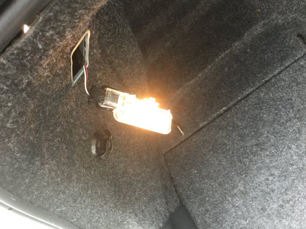

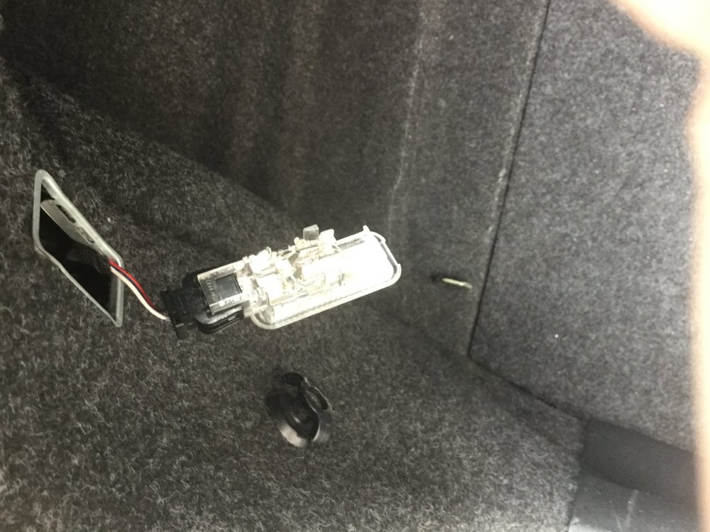

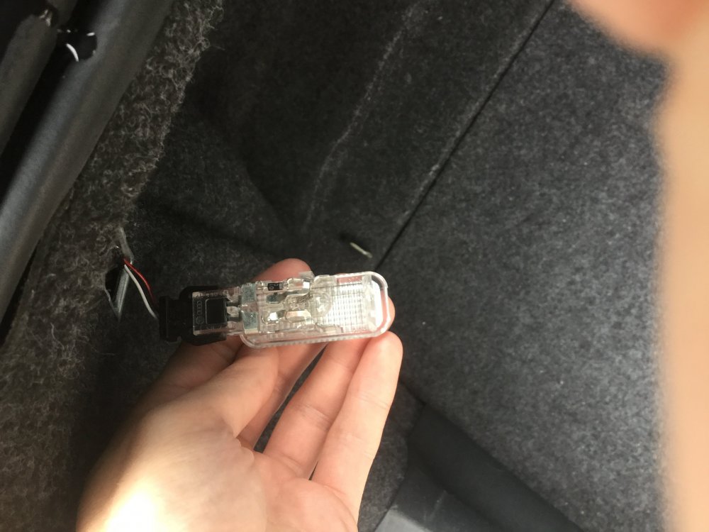

Mine look different to that, took a couple of snaps
Oh right, my bad, I remembered wrong.
Yeah, it's the standard ones you have, you can just grab the top of the bulb and pull it out, though it can be a bit tough to get out. You can also pry it softly from the bottom, but do not use anything conducive, as you could blow the internal-lights fuse.
Ah ok cool. I’ll try just yanking it then haha. Cheers for that!
