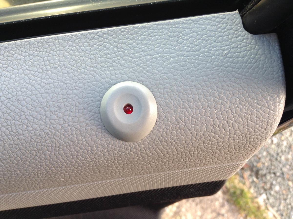

Hi, today as I got out of my car I noticed the red light on the drivers door for the alarm was on. I have never noticed it being on before. The alarm works fine and the light flashes correctly when turned on.
Should it be on ?

No, the red light at the top of the door ( where years ago a plastic piece would be and you would pull up / push down to open and close door ).

It flashes when alarm on but it stays on when not in use.
If it's constantly lit it indicates a fault.
There's a TSB for a fault in the door, requires a resistor iirc

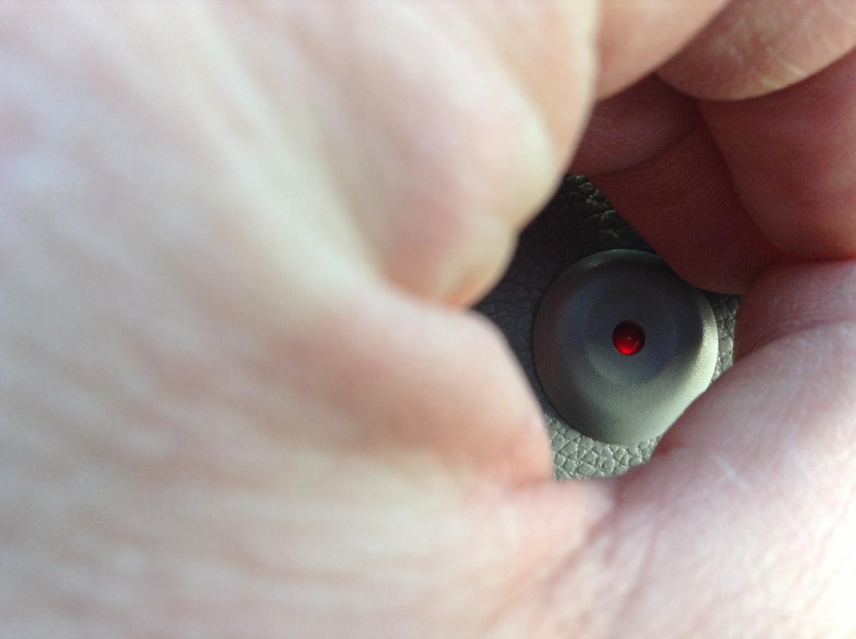

Added photos
