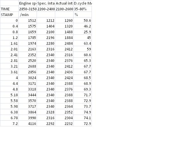

Just a quick one in reference to some vcds logs i did earlier tonight.
I'm sure someone had asked a similar thing earlier today, so I was going to compare results with theirs and work out the old 'has my car been mapped' episode!
Basically just asking the same as they did, I've done a quick search.. but couldnt find anything to really help.
- Are the attatchments ok? having trouble getting it to work
Edited by Phil-J

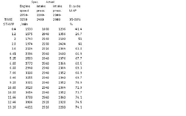

For me, it doesnt look like its be remapped, its boosting at 1.3Bar which is stock. Remapped is generally 1.5/1.55bar
Stock
It was mapped! More reason to get it mapped faboka style, I bought an mpps cable last night, so will be in touch when that arrives!

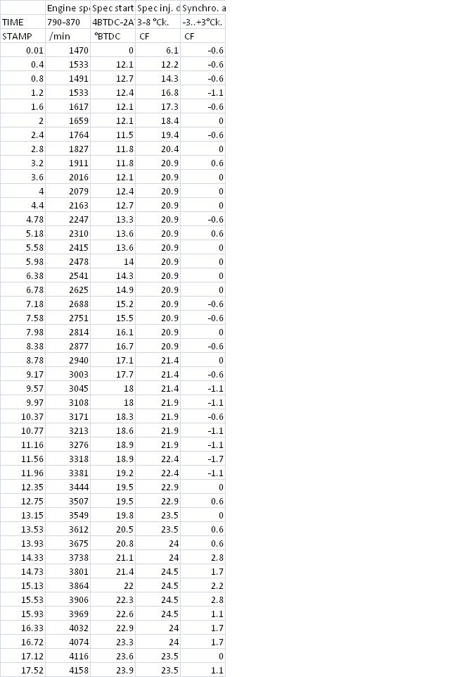

Could be fuel a fueling tweak remap. I had one years ago from DMS.
Log group 4. Your expecting duration of around 22 degress at 4k rpm.
I'll have a go with group 4 tonight and see where it's at! Cheers..

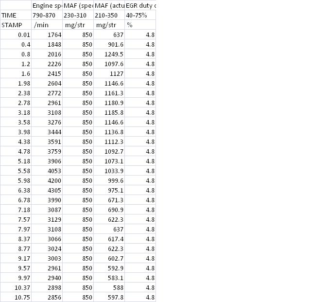

So, i've done a couple more MVB logs tonight..
Just to see if things look right before I get to the point of mapping etc.

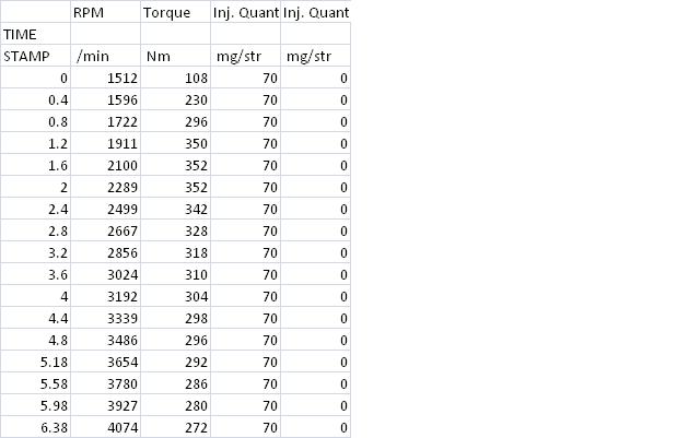

Looking at group 4 your running more duration than stock. Stock is 22 your on 24.
So looks like a very mild fuelling only remap.
Looking at group 4 your running more duration than stock. Stock is 22 your on 24.So looks like a very mild fuelling only remap.
Room for improvement though?! :D
Correction this is a stock file. A BLT stock file. BLTs run more fuelling than ASZ this is why they make more power.
