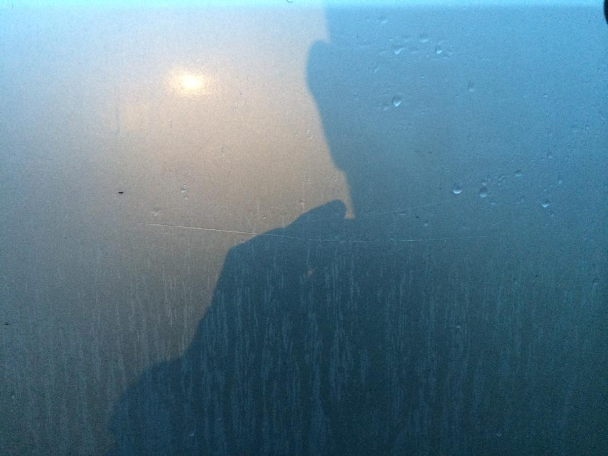

Went to get my hair cut in Stockton today, left the vRS parked in a side street and came back to find a couple of deep scratches down the passenger side front door (on the road side), I don't think they will 'T Cut' out, anyone got any ideas of how to get rid of them ?

I've added a pic ... not sure if they are that visable on there though
I'm afraid t see that the off-the-shelf stuff isn't rally up to much.
As said before, if it's is deep and you can easily feel it with a. Finger nail it is probably past even machine polishing.
A 'smart repair' guy might be able to sort it but they usually trot out the mantra "well.... If it was at the edge of the door I could 'lose it' but (sharp intake of breath through teeth) I think this may be more costly....."
Failing that I'd go to a couple of small independent body shops that have oven facilities etc.
Machine Polishing will probalby take the bad look off it, but wont get rid of it :(
Pro job it looks like.
