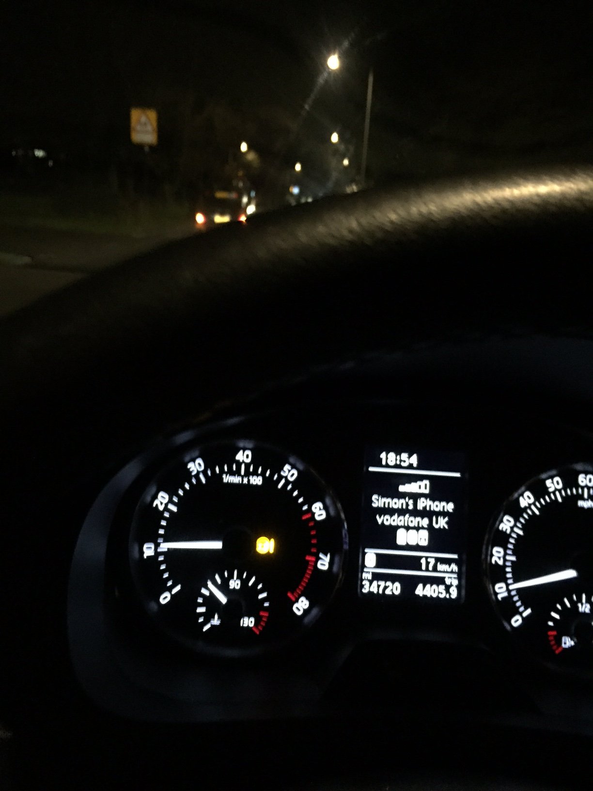

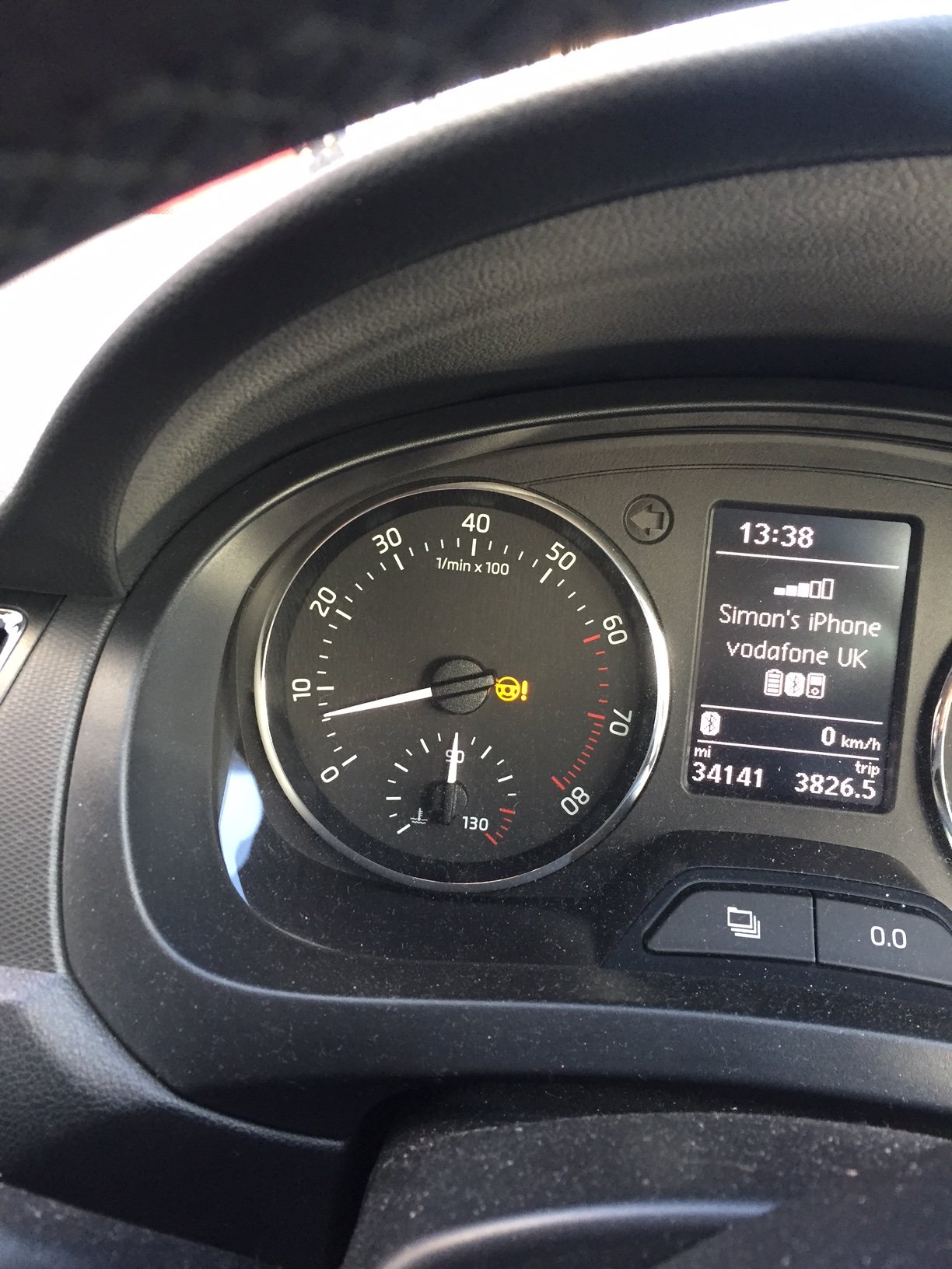

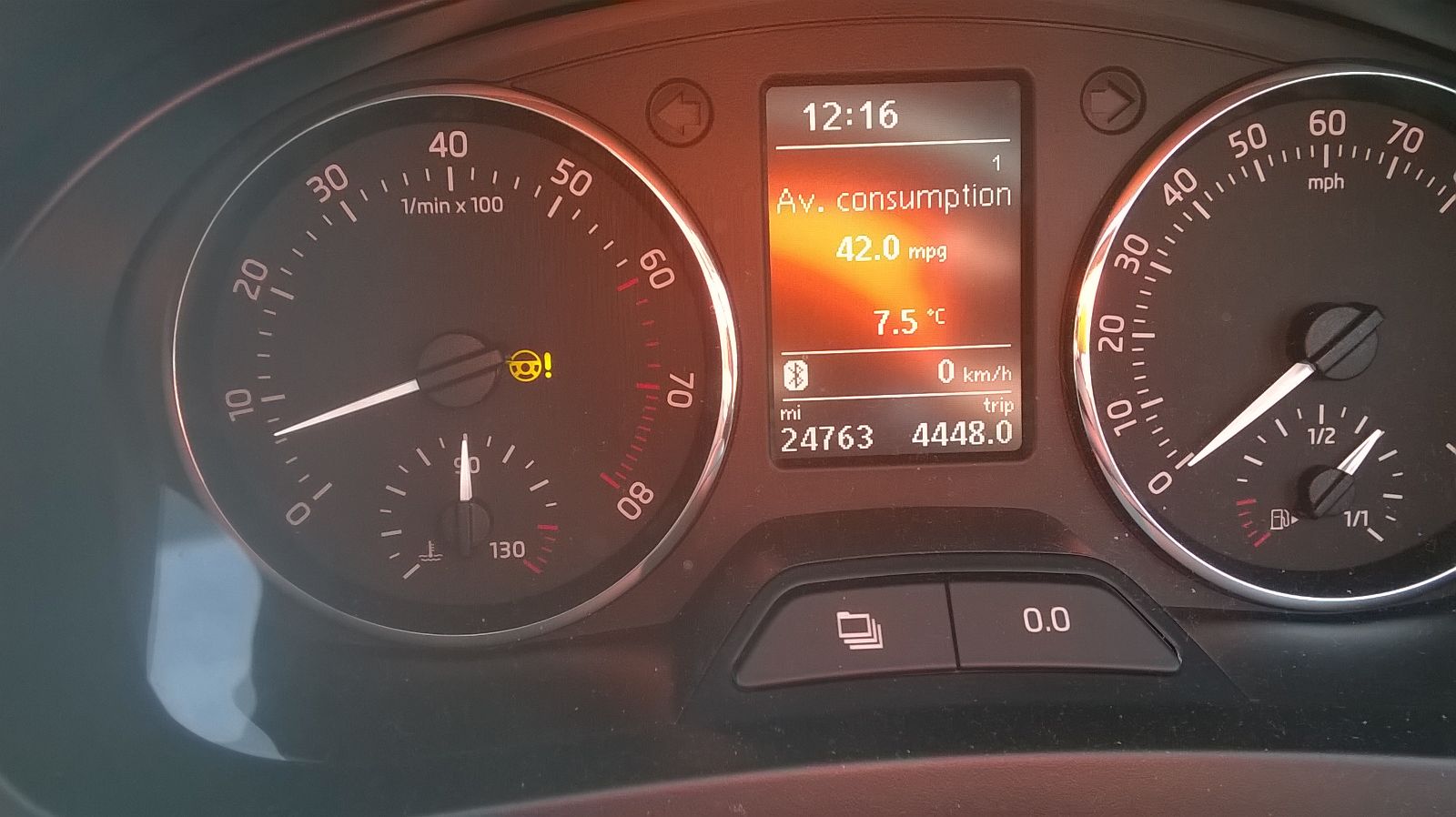

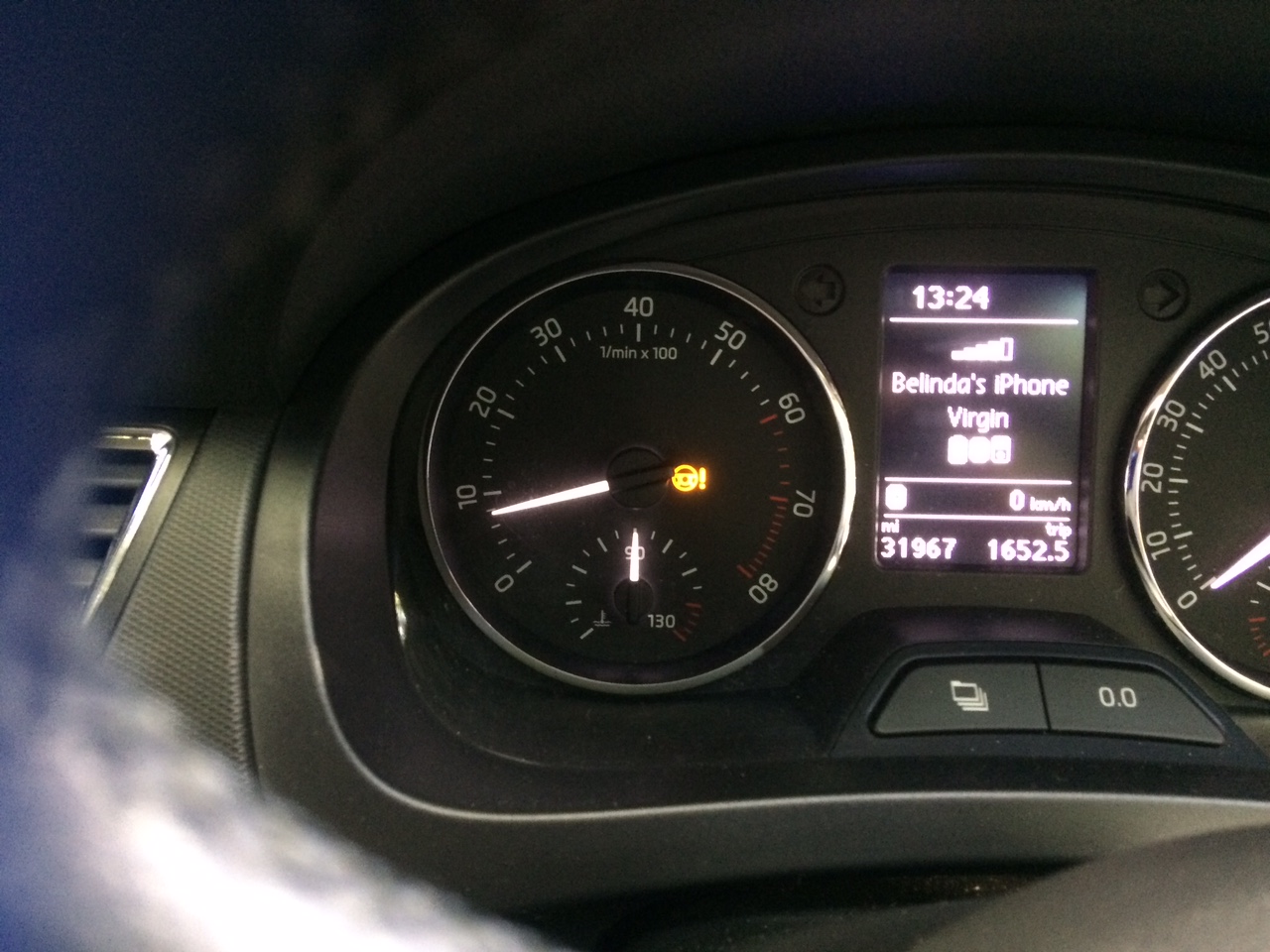

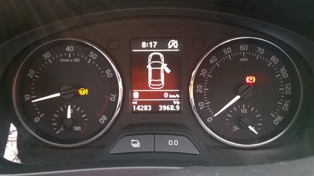

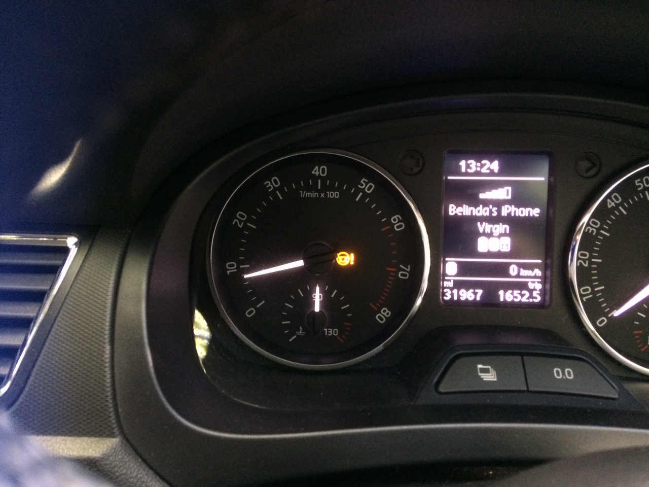

Dear All

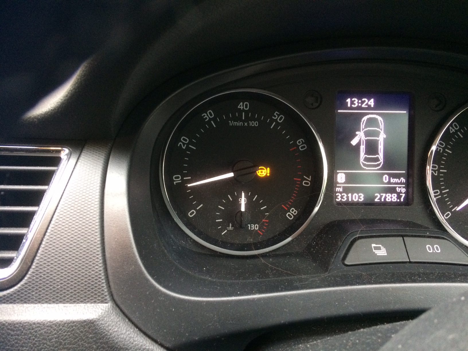

Its is now 3 years and 6 months since I bought the brand new Skoda Rapid and unfortunately I can report that the steering issue is still a problem and locks intermittently including when pulling out of junctions. As requested I have had the car checked a number of times by Skoda authorized dealers and each time they state they can find nothing wrong with the car. As I keep stating to them  the steering warning light must come on for a reason which in my case is when the steering actually locks while driving. It happened recently when pulling out of tricky junction where I needed to pull across traffic at speed to turn right. After numerous calls with Skoda Uk customer services they have basically washed their hands of the issue saying unless the dealers can find a fault there is nothing wrong with the car so basically are not trusting my word. I have attached photos of when the fault happens just to prove I am not making the story up and as the last dealer who I spoke to stated you should use the words the car is not fit for purpose. I do not want to put people off buying a Skoda however I will suggest if this happens to you at all during the warranty period do not accept the car back unless you have proof it is fixed and if it happens a second time ask for your money back. Skoda can not expect customers to drive cars that could potentially lead to serious accidents and even then expect to sell them on which I will probably do and therefore potentially endanger someone else's life.
