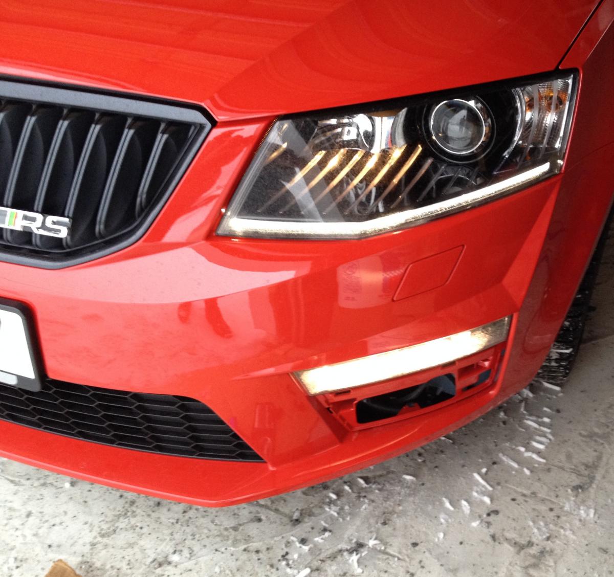

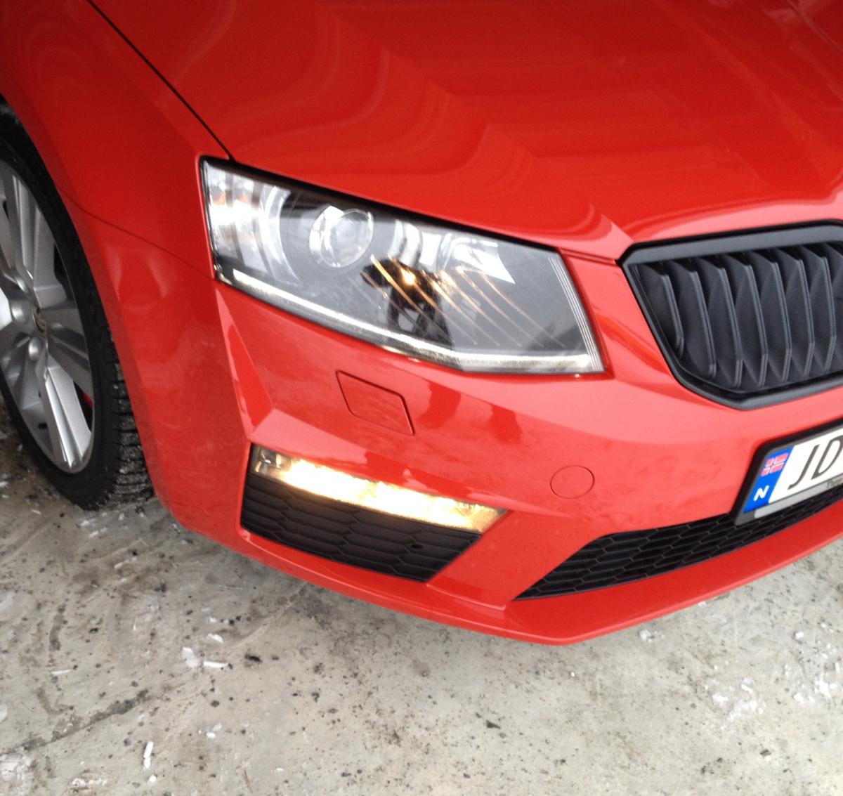

Changed the foglight bulbs today. Its correct with H16, and i installed the ones from ledperf. Not a huge difference, but they are a bit whiter and match the leds a bit better:
Originals:
The new ones:
No errors.

Good to know, thanks for the update and pics :)
