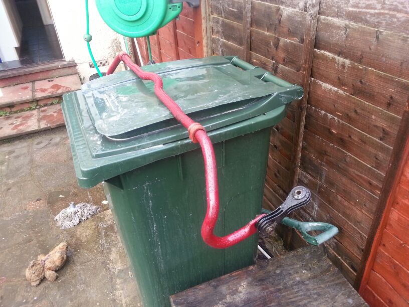

Just acquired front and rear anti roll bars. Rear is fine as I know about it but the front anti roll bar is my problem.
it's an eibach 25mm front but the ends are looped and i have been told that the vrs have straight ends on the bar. I cant ready the eibach part number to check it out and see if its correct.
it also came with 2 rubber drop links about 6 inches long attached to the bar. So it looks like it should attach to the wishbone and not to the strut.
can I use this bar or not ill try and get some pictures up later
Could use it if you've got the holes on your bottom arms, but it's not the right bar for a vRS
The front end set up on the vrs is different to non vrs octavias. The anti roll bar link goes to the shock absorber hence why the link is so long. The other set up uses a shorter link and bolts to the bottom arm and looking at your bar that's the type you have. I suppose if the hole is there on the arm you could use it but IMHO you'd be better keeping your standard front anti roll bar rather than doing that.

No, not with bushes on each on the drop links, and where they mount to. It is nowhere near as rigid. However, the fact that it is a 25mm bar might make up for it, but I still wouldn't bother. It's a lot of arseache changing the front arb for something that may turn out to be a downgrade.
