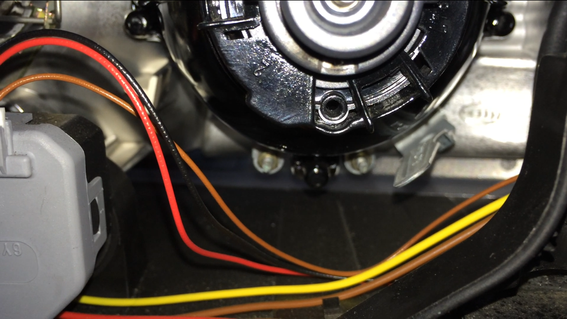

I'm trying to change the D2S HID bulbs on my fabia, but have encountered a problem.
Behind the plastic covering and electrical connector there is some kind of ring holding the bulb in place.
I have tried to turn it both counter clockwise and clockwise with as much force I feel comfortable with, but it doesn't seem to come loose.
Does anyone here know the correct procedure?

Im now having this same issue.... its stuck solid.  anyone got any tips?
Where is this bulb on the fog ?
This isnt the fog light this is the main hid bulb on the headlights
Look at new bulb for any hints as to rotation or clips?
Figured it out, little lugs need twisting into the right place
