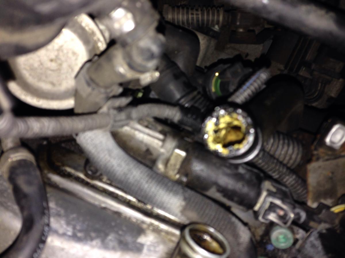

Just had a quick look and the lower (plastic) breather pipe seems in tact externally but rather clogged inside. Any tips for cleaning or is it at a point where it should be replaced?
The upper y pipe has deposits but no where near the shown lower pipe
