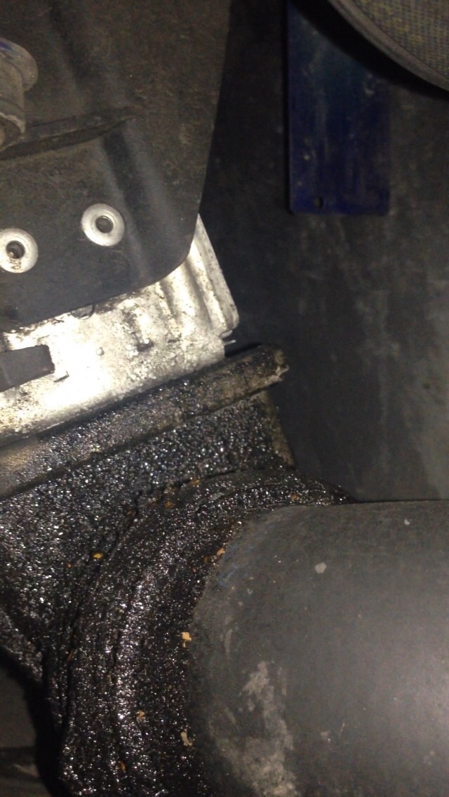

Seem to have an oil leak here. Not sure what part it is though as I've not had the front bumper off this car yet.
On looking myself, is the alloy section the side mount?
its the seal on the intercooler hose,pennys from main dealers
Yeah, the alloy bit is your side mount intercooler. The pipe coming away is the boost pipe, these have two lugs which wear over time, also wearing the rubber seal down, hence... Oil leak!
i changed mine the other day £4 delivered from tps mate

Don't suppose you have the part number(s) Sean?
Sorry mate no I don't but just ask them for inter cooler seal they will know what your after seems quite a common part good luck
It seems to be a common fault, and it appeared recently on SWMBO vRS; as stated circa £4 and easy to fix
