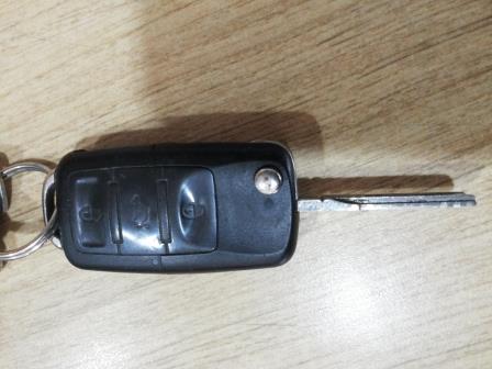

Do you have a key fob to remotely lock and unlock?  Or just central locking from the key?
Either way, hold down the lock button on the key fob, or hold the key in the lock position and it will close ALL windows (if you hold it in unlock position, it opens all windows).

Hi! PDIBK,
Yes, I do have the key, but i tried several times, window never come up and down after long push

Ok, so try it with the key in the door lock, actually turning the key to lock the doors and holding it in the lock position.
