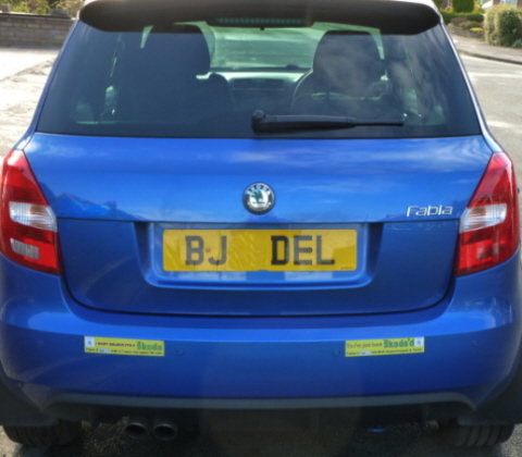

I've done precisely that (see pic). It works a real treat.
Mate what's going on with those bumper stickers!? Does the right hand one really say "you've just been Skoda'd"? Haha
Yep. It sure does. (see pics) Only put them on for a joke to wind up my mate who has a brand new Fiesta ST. I can see him off at the lights no problem, but he catches me up on the windy lanes. Reckon mine's faster on the straight though.
