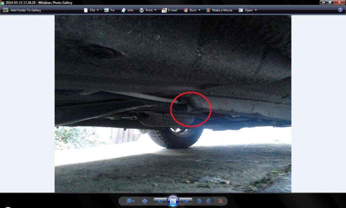

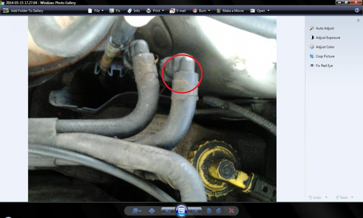

Quick question on the removal of the damaged fuel line.
I've attached a couple of photos. Looking at photo1, a plan view of the fuel line connection from the engine bay. The fuel line is circled in red. If I remove the the horseshoe clip, and then prize the fuel line from the holder, can i withdraw the fuel line from the car? Obviously the fuel line would be unclipped from the under body of the car as well.
The reason i ask is because if you look at photo2, there is a protective cover over the fuel line. Are the lines clipped together under the cover?
Cheers
