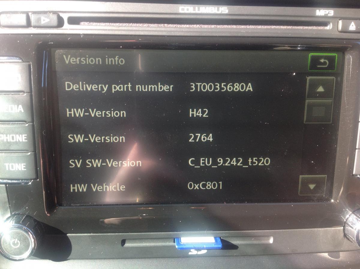

Jerbear: what part number is your Columbus (and year)? I presume it worked correctly in your Vrs?
Can I get details off the screen or will I have to pull it out again?
I presume that you have tried turning sound up and down with the knob on the Columbus to eliminate an issue with the unit?
We did that. And it was fine.
Does seem to be a communication issue with a Columbus that pre-dates the vehicle.
Agreed. Maybe a software update will help as its only on 2764.
Could be worth a try.
Jerbear: I have 4020 firmware disk which I have used on my Columbus with same part number if you want to try that.
Worth a go. PM 'd you.

An upgrade to 4020 (from 27xx) sorted the button. Thanks to Adam for spotting the older firmware and suggesting trying an upgrade.
