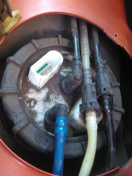

My partner has a 1.4 8v 6n polo, 98 reg which I'm trying to change the in tank fuel pump on. Problem is, I haven't got a clue how to remove the hose clips holding the fuel hose on to the pump.
Any ideas anyone? I realise its not fabia, but its the same car almost and we're all in the happy VAG family together right?!????
Thanks all!!
Push and twist?
Solved it! Theres a coloured catch which you simply push on the side of the connector. Silly me!
