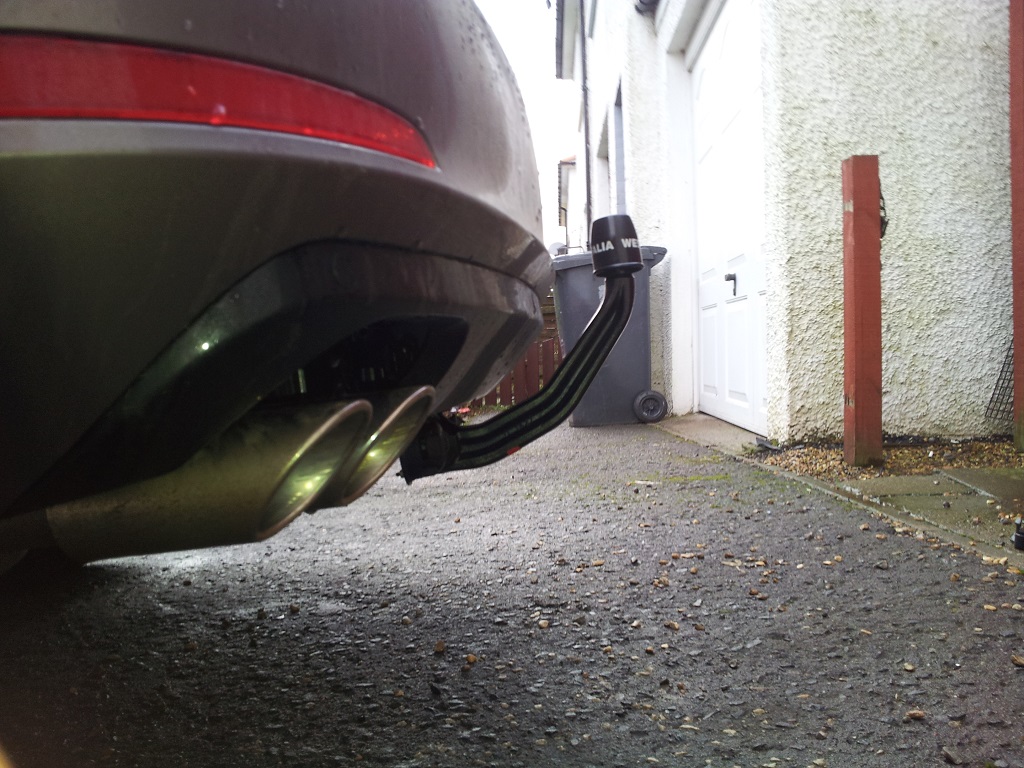

I've got the Westfalia detachable fitted to my Superb - when removed you wouldn't know the car had a towbar. The only part of the bumper that should be cut is the black plastic 'apron' that you can't really see. Cost was £450 12 months ago

Westfalia make the OEM towbar and the locking system is brilliant and easy, I had one on my old Octavia and Superb1 and thought they were great, to be honest their that good it's a no brainer if budget isn't an issue. Unfortunately my new Superb2 has a fixed towbar and I hate it, I'm always on the look out for a detachable Westfalia towbar as if I could find one at the right price I would swap it in a heart beat!

That is not true. The OEM Skoda towbar is made by Prof Svar and looks like this:
While the Westfalia (which is also a very good choice b.t.w.) looks like this:

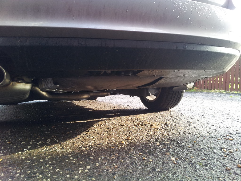

Did they change that with the facelift? I own a pre-facelift Combi, and fitted my Westfalia tow-bar myself. In my bumper there was definitely now cut present, and I had to make one myself. This cut however is not visible at all, since it is on the bottom side of the bumper.
This is the cutout  on my FL model for Westfalia Bar

Where's the cutout? and if I'm getting new, should I just go factory fit?
Have highlighted cutout in red. I had mine done as a dealer fit, as I got a good deal. My dealer pointed out that the factory wiring prep doesnt include charging and fridge circuit for my caravan. It mentions this in brochure in small print on options page.
Yep they did. The bumper was already cut out and all fl's are tow bar preped except the greenline. Can't see the cut out unless you lie under the car.
