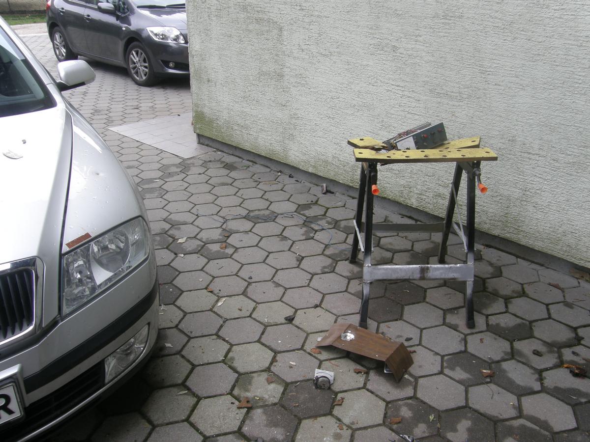

This car was hit by a lightning, when my father was charging a battery.
All of electronic modules were damaged through can wire mostly.
It is on the road again, some minor problems are still there.
I would be very grateful for your help!
One picture attached showing what is has left from a charger (yes, homemade).
