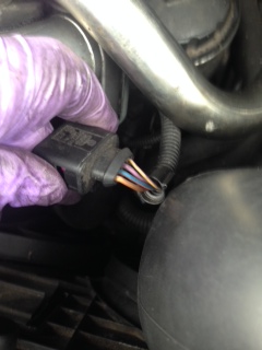

I'm thinking it could be the wiring as one of the wires is under some stress as there's a lot of tension on the harness.
How do i test them with a multimeter?  There are 4 wires numbered 1-4, 1 looks the most stressed.  I don't have any wiring probes.
i've attached a photo of the harness.
