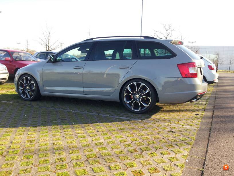

Hope it be like this before easter
Size of the spacers on this?
No idea not my car. Just a pic i found. Buy wheels with the right ET, you dont need spacers.
Dont hjelp if you want the original extremes.
Dont go for the original wheels, waste of good money, there's so many nice wheels out there.
Really you buy org. Wheels, and then you buy spacers that will ruin the wheelbearings....... Don't get it...
Go for wheels with ET 42-45 max and it will fit to the edge of your frontwings/ fender.
I have ET 38 on a 8,5" x19"and it looks perfect. With 225/35-19 tire.
So if you have a 8" wheel you can have ET 40 and it will fit.
