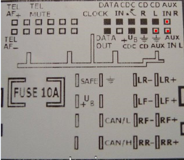

My 07 L&K has an Aux In in the centre console and I'm able to select Aux In on the HU (Audience) but I get no sound what so ever. Upon investigation, I've found that the 12 pin socket connector where the Aux In cable should connect too is missing from the back of the HU. The other 12 pin socket connector is there for the telephone. Can anyone please advise ?

Yes its part of the blue mini 12 pin plug within the quadlock but you say that is missing??
Yes mate, its not there, the other one with the phone connections is but not the aux one
I also have the same parrot kit and it comes with two connectors one the original plug connects to and one that now goes to the radio, it does not use the telephone in connectors as it sends its audio direct to the speakers I think that your connectors may be messed up. Do you have a multimeter that you could test the centre console USB cable to blue plug wires?

Is the picture shown in the first post of your unit or from online. The Audience connection picture I have shows no Aux connection at all.
mine definitely shows Aux L Aux R and Aux earth
