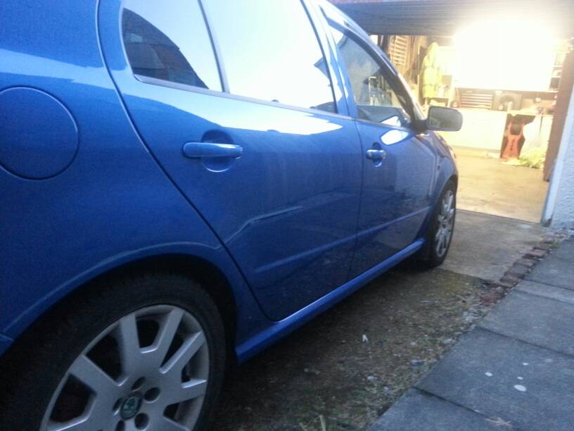

I just used a heat gun and elbow grease. Here is mine without them. post-110602-13978533481111_thumb.jpg
