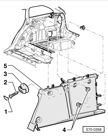

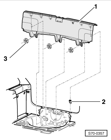

Diagrams and instructions here.
http://workshop-manuals.com/skoda/octavia-mk2/body/body_work/bumper/rear_bumper/
You will need to remove the inner side panels to get to 2 bolts either side. On the left they hold the CD changer in place. After that it's all small screws around the edges. Don't miss the one at the very tip of the bumper where it meets the wheel arch. It's hard to see under the mud and is accessible from the wheel arch. Skoda use a little silicone on the sides so you will need a little force.
