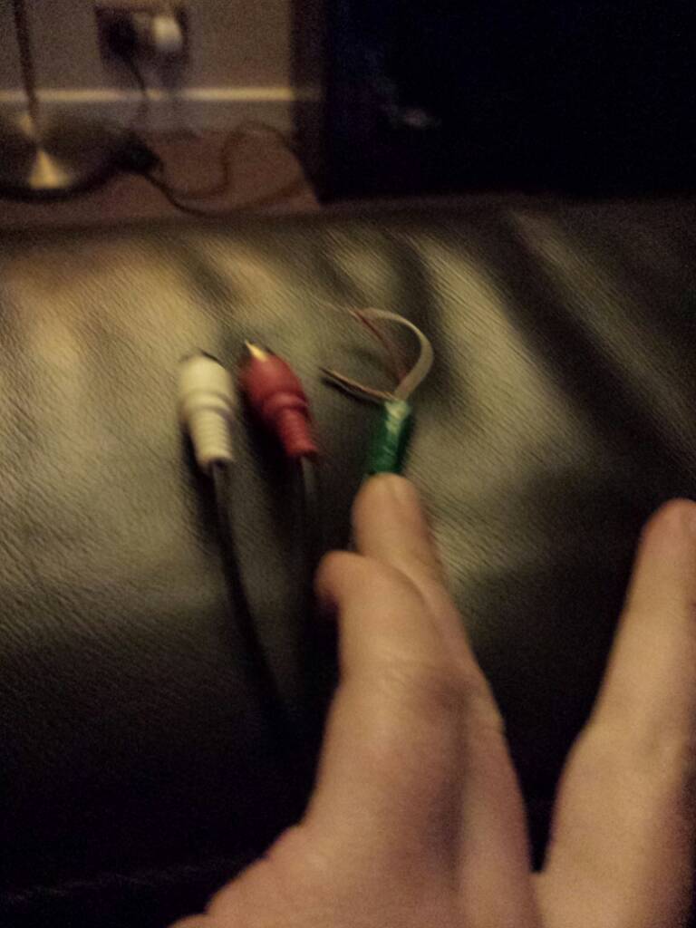

Ok thanks for that, my mate showed me how to connect an rca to speaker wire using a connector block so didnt have to purchase any adapters/converters. Abit of a bodge but it works :).

How does that work? If all did was attach the cables together you should have issues
Red and white cable goes to 1 speaker wire and the copper wire goes to the other then just seal it up. It works because ive seen and heard his.
Sent from my GT-I9505 using Tapatalk
My friend said in theory it shouldnt work because of it being the wrong signal but because headunits have a small amp it acts as a pre amp giving a strong enough signal for my amp. It also because the way its wired a mono signal is converted to stereo with both coloured and earth wired in the photo.
