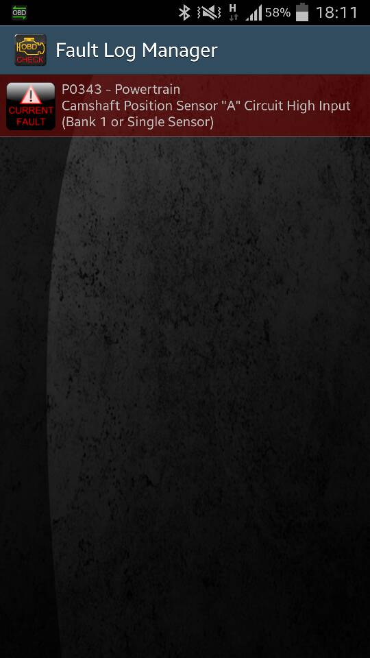

post-110442-13993099676252_thumb.jpg im showing that fault code. Is it likely that? How do I go about cleaning it before replacing?
Sent from my GT-I9505 using Tapatalk
most prob that is why
It could well be the crank sensor at fault and not the cam sensor.
any way to know which one it is? Is it worth cleaning both sensors if easy enough to do?
When i had my 1.6 octavia it was struggling to start, cutting out at traffics etc.. I had a cheapo vag-com scanner from ebay which said it was the cam sensor. Got one ordered and took it to a local guy who had a garage in his back garden who fitted it (sensor on 1.6 engine is behind the timing belt) he plugged it in too and it said cam sensor. Day after it was still not starting. Turned out it was the same code for cam and crank sensor fault.
The thing is the car should start without a cam sensor but run crap.. If the crank sensor is duff it will be a pain to start, it will start eventually using the info from the cam sensor

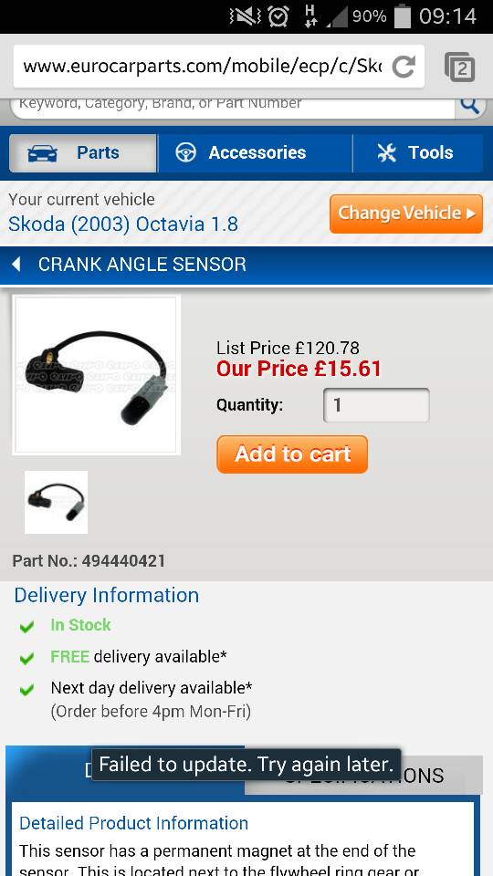

Cheers. Noticed on ebay I can get both crank and camshaft sensor for about £25. That seem right?
Is that the correct crank sensor?

Yeah that looks like the correct sensor. See if they have a dipstick tube aswell. It will probably break while you do the sensor
