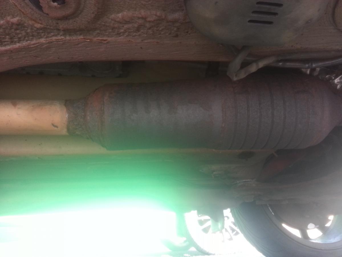

Get a picture of the CAT you have fitted and post here, usually CATS are replaced with sports versions which should be less restrictive.
yeah i'll get a pic up as soon as i can, haven't had the chance yet. Doesn't look like a sports cat, looks like an old piece found off a beaten up tranny van or summin! :o looks aweful! Found the invoice that went back to when it was fitted, back in feb 2010, and it cost near enough 500. Really doesn't show for it! And also looks like the pipes are about an inch and a half at most!

This is the piece of poop cat in question. Thoughts? The standard one doesn't have grooves around it like this one does!
