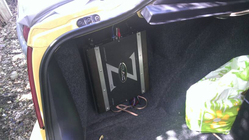

I'll try and get some pics later, but I removed my CD changer abd made a custom bracket to mount the amp in it's place. Keeps it out of the way
Sent with Tapatalk
Just need to tidy the cables up a bit if I can be bothered
