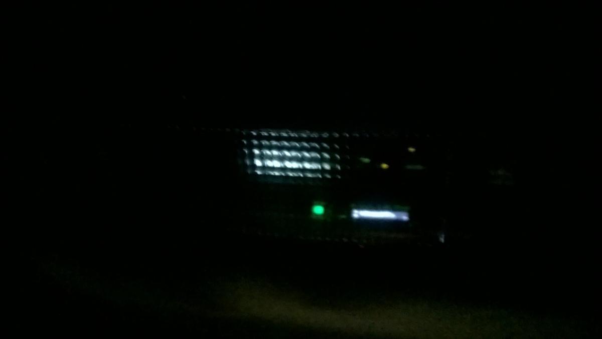

I have bought some LED lights off ebay and for some reason they are constantly on but only dull.
I have added a photo to show this issue.  Does anyone know why this is happening and if there is a fix?

Which fitting are we looking at in the picture?

What light are we looking at here, internal or external.

Sorry all. I have a 2008 pre facelift VRs diesel. The picture is the centre light in the front, but it's all internal lights. I can't find the eBay link sorry
Ah, I had this with my first set of LEDs ('07 Elegance). Swapped them out for a set from FIZMOs from eBay. Not had a problem since. :)
FIZMOS work excellent in mk2 and mk2 fl
I used these for the map lights, puddle lights, boot lights and the footwell lights.....
