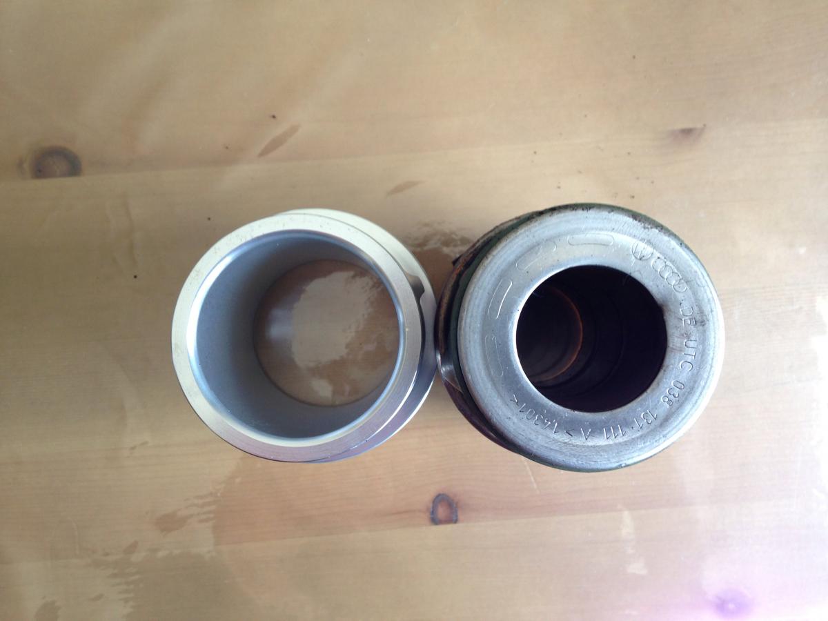

Aftermarket turbo coupler (pics inc)
Check out the differnce in diameter to the OEM one, will this have any negative/positive impact.

The standard one will help to speed up the air for sure. But once mapped and running larger turbos it'll end up a restriction
I fitted the dark side one, car already mapped when standard coupler was used. Did I notice any difference? spooling noise maybe slightly louder and that was about it.

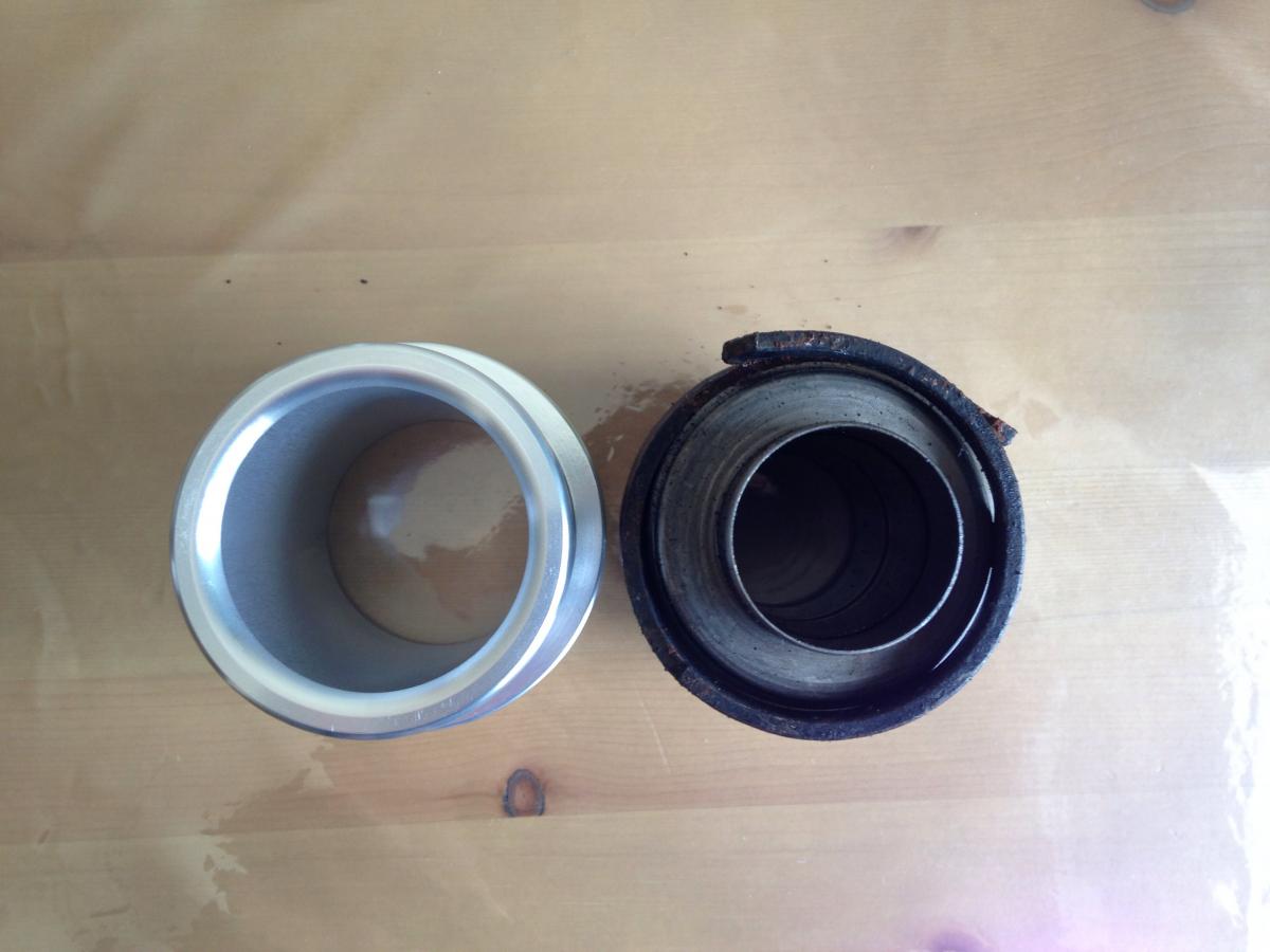

I've only bought it because my ones worn out and have oil seeping out from the connector lugs (common problem)

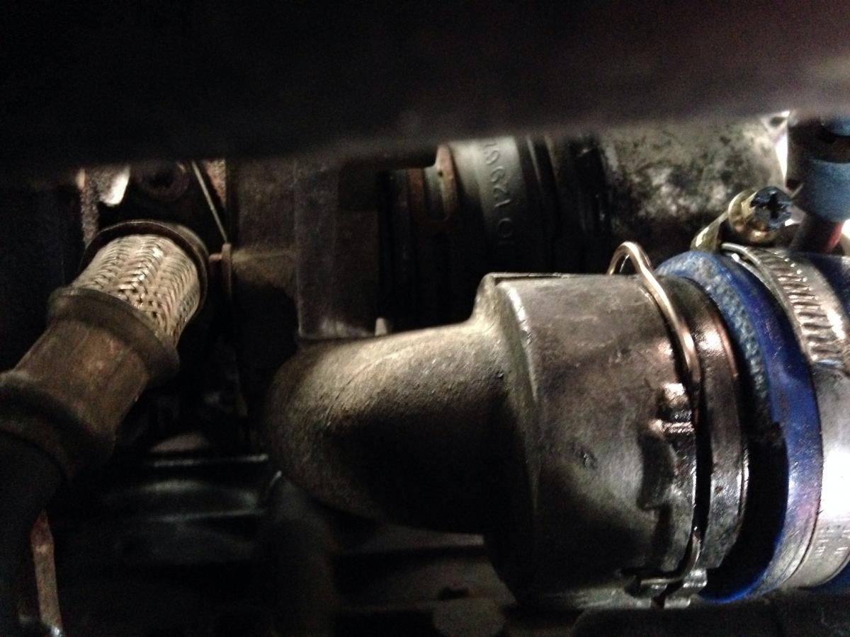

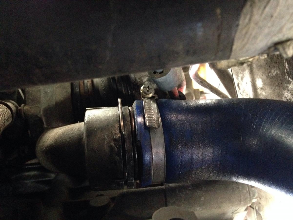

Any ideas how to remove the old one and fit this, looks like it's going to to awkward to remove without any bent nose pliers :-(
How about if I push the retaining clips in with flat head screwdriver?
Any tips would be great!
Cheers

How do I disconnect the coupler?!
I assume it's something to do what that clip that's sticking out?
Please help! :-D
Pull thw clio out
doable with fingers or a screwdriver
you will feel the clip settle as it cones out 2 cm then you can slide pipe off. May require some waglling
if you studdy whats going on as you pull it. All will become clear
Sorted! Thank you very much :-)
FYI - just driven 120 miles and power delivery in the higher gears seems a little better.
Indeed you can also hear the turbo spool up slightly better
All in all, worth £22 IMO
