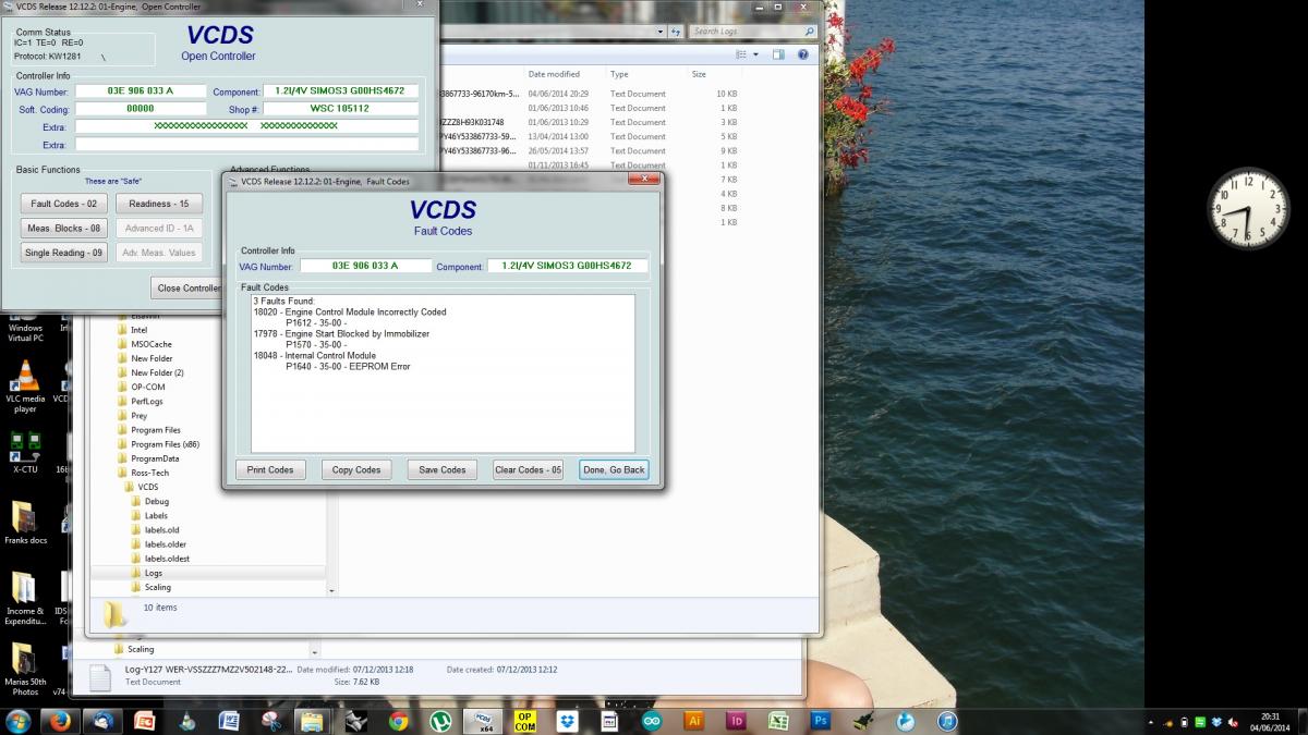

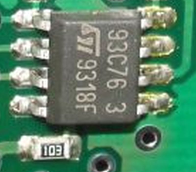

Here is the saga, tried to get a dump from the engine ecu immobilser eeprom to obtain the Cars SKC code, to supply a spare key..... I WAS UNSUCCESSFUL !....please see log below showing XXXXXXXXXXXXX instead of VIN/IMMO numbers...these i have from a previous Auto Scan , further down the post.

I have used VCDS on it before and i have saved the VIN/IMMO and Soft Coding numbers , could anyone advise me of how i can reprogramme the ECU to get the VIN and IMMO to show up in the EXTRA window and get the coding proceedure ?..Please note i do not have the cars SKC number....my attempt a retriving this via the eeprom dump did not work...
Any help on this would be much appreciated,
If you need any further info eeprom dumps etc please let me know.
Cheers
Derrick
Try code 00031 for engine ecu
Can only be recovered by obtaining the skc number and then the ecu can be re programmed thro the immobiliser. A dealer may be able to supply SKC. Have you been using vag commander to try and obtain key code, they are not suitable for your ecu.
