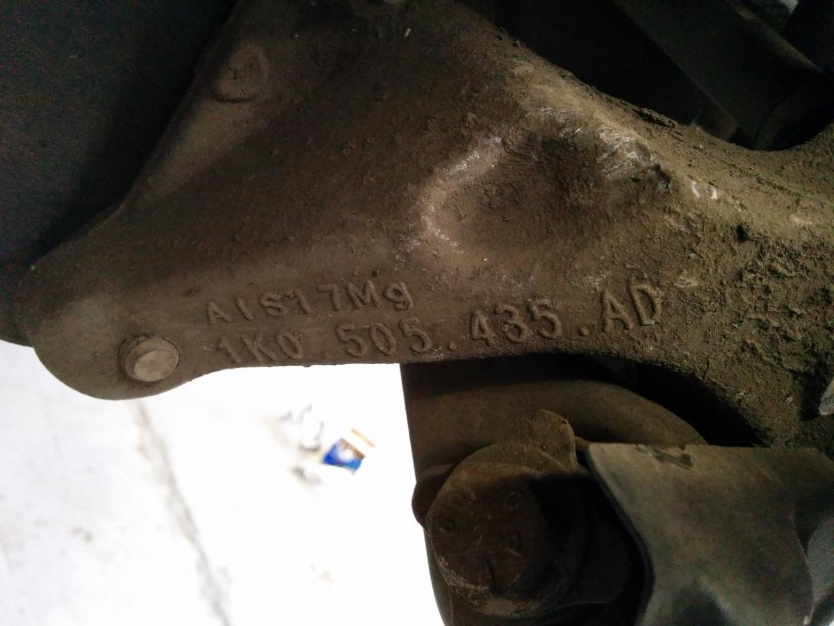

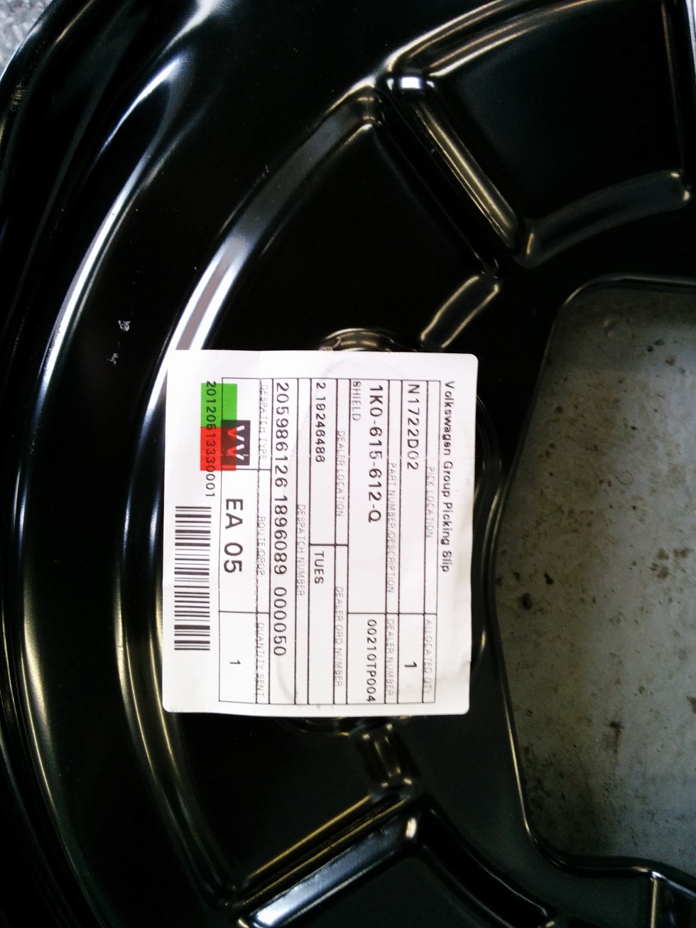

The standard 286mm back plates from the VRS don't fit because of the rear driveshafts with the Scout. So I tried the back plates from a Mk5 Golf that had 4WD and 286mm rears (R32, I think?) - but these use a different hub (three screw fitting for back plates rather than four on the Scout)

This is the rear hub from the Scout

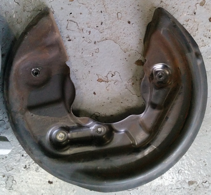

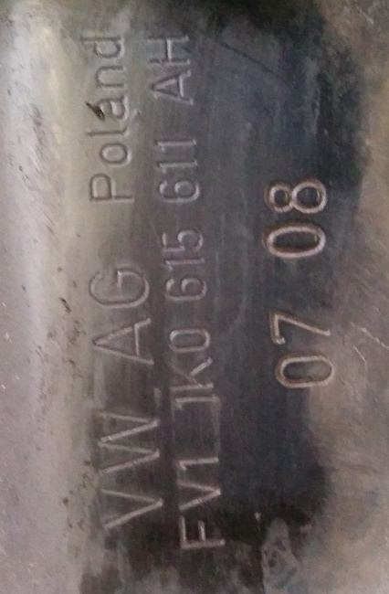

This is the existing back plate showing fittings and then the part number
Finally this is the part number for the Golf hub that doesn't fit.

After some searching on the interweb, I have found out that the required parts seem to be;
5N0615611E - Left Side
5N0615612E - Right side
Seem to match with the pictures the thread starter provided with 4 bolt holes.
