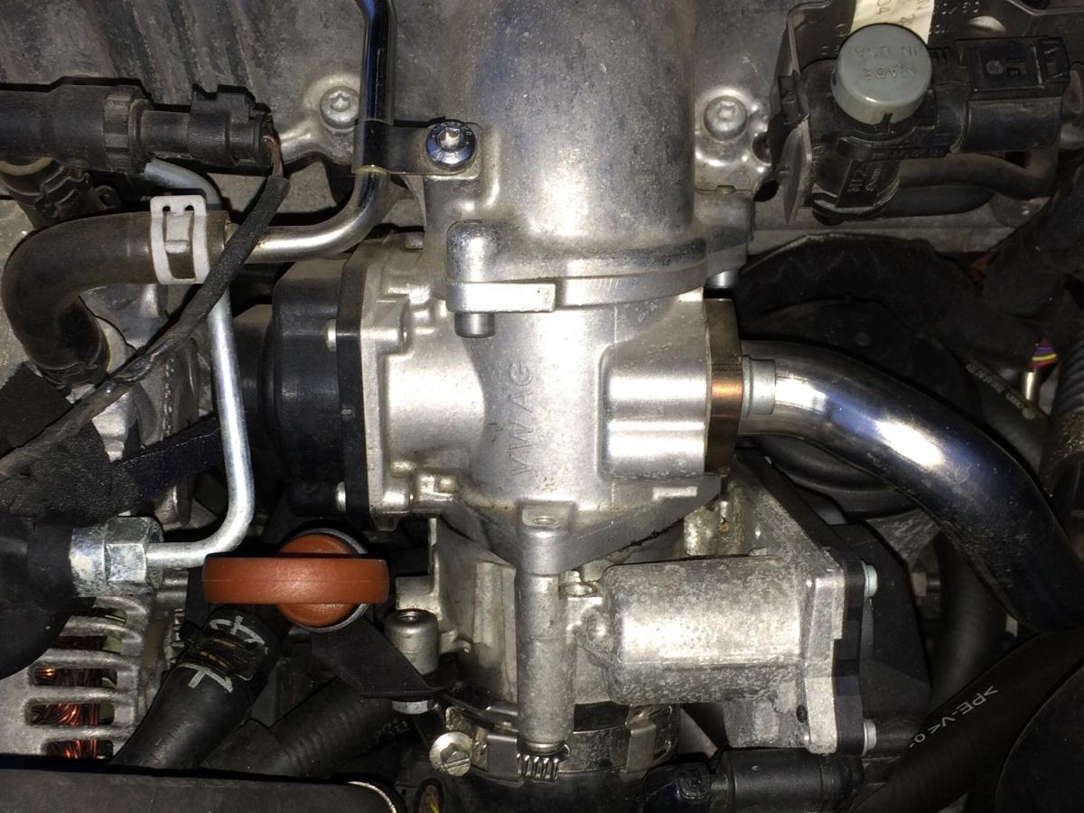

Sorry to revive this thread but is the silver thing with VWAG written on it in centre of picture the EGR valve?
yes that is the EGR valve
