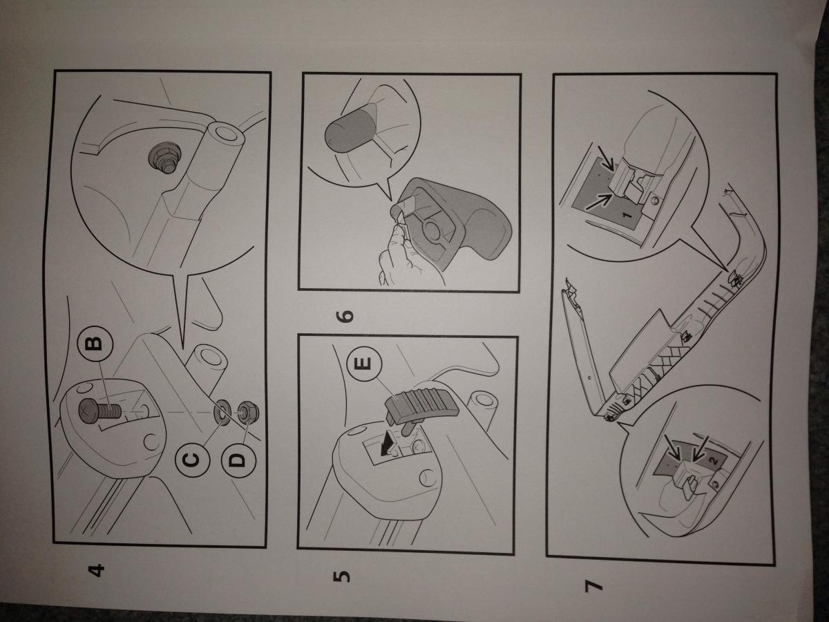

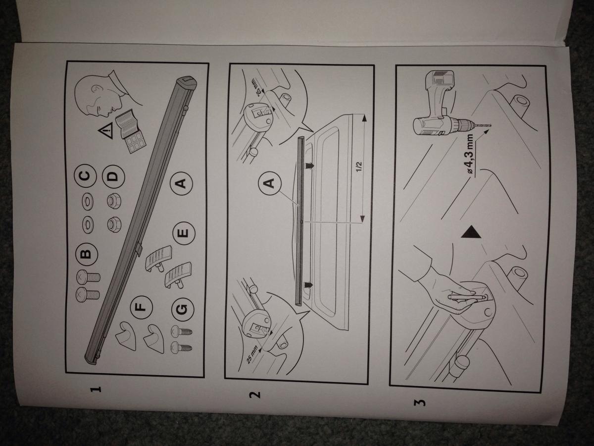

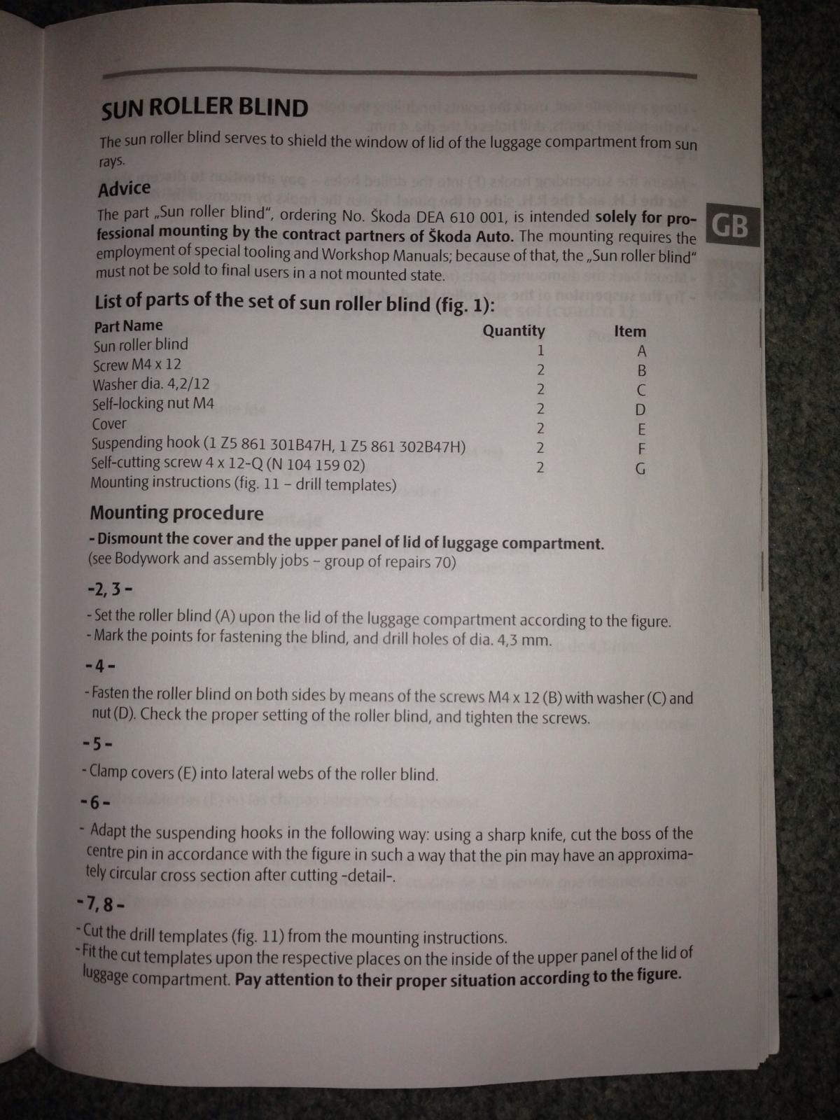

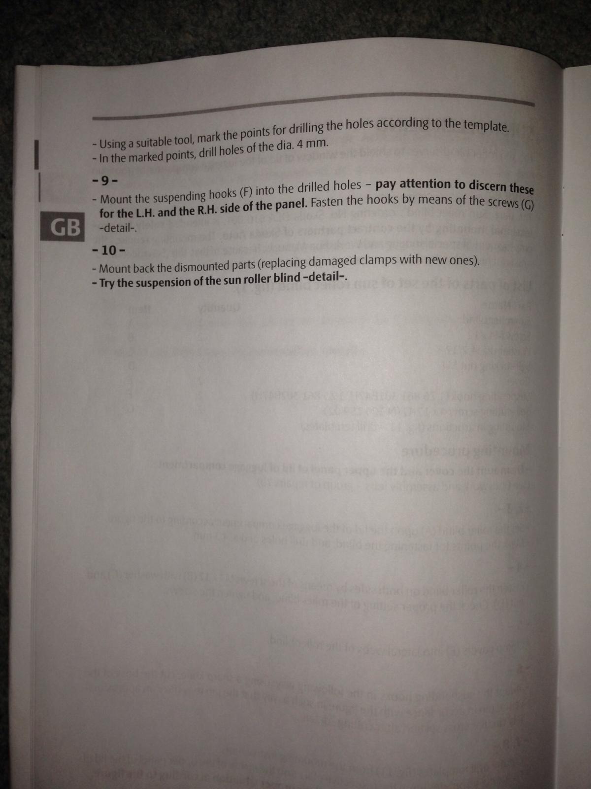

Yes I have instructions. I will try to dig them out for you.
Instructions...diagrams to follow

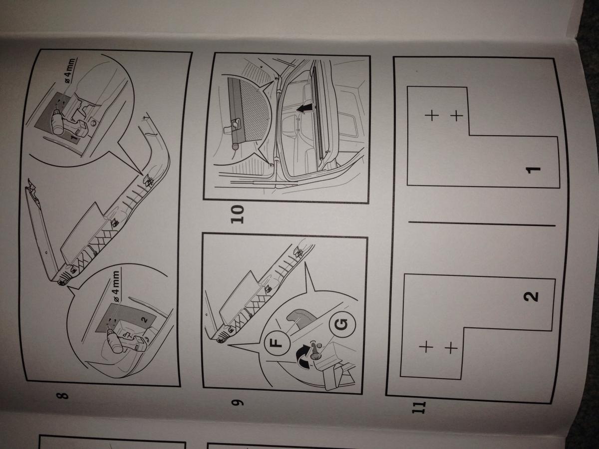

Diagrams...
Last one...happy fitting.
