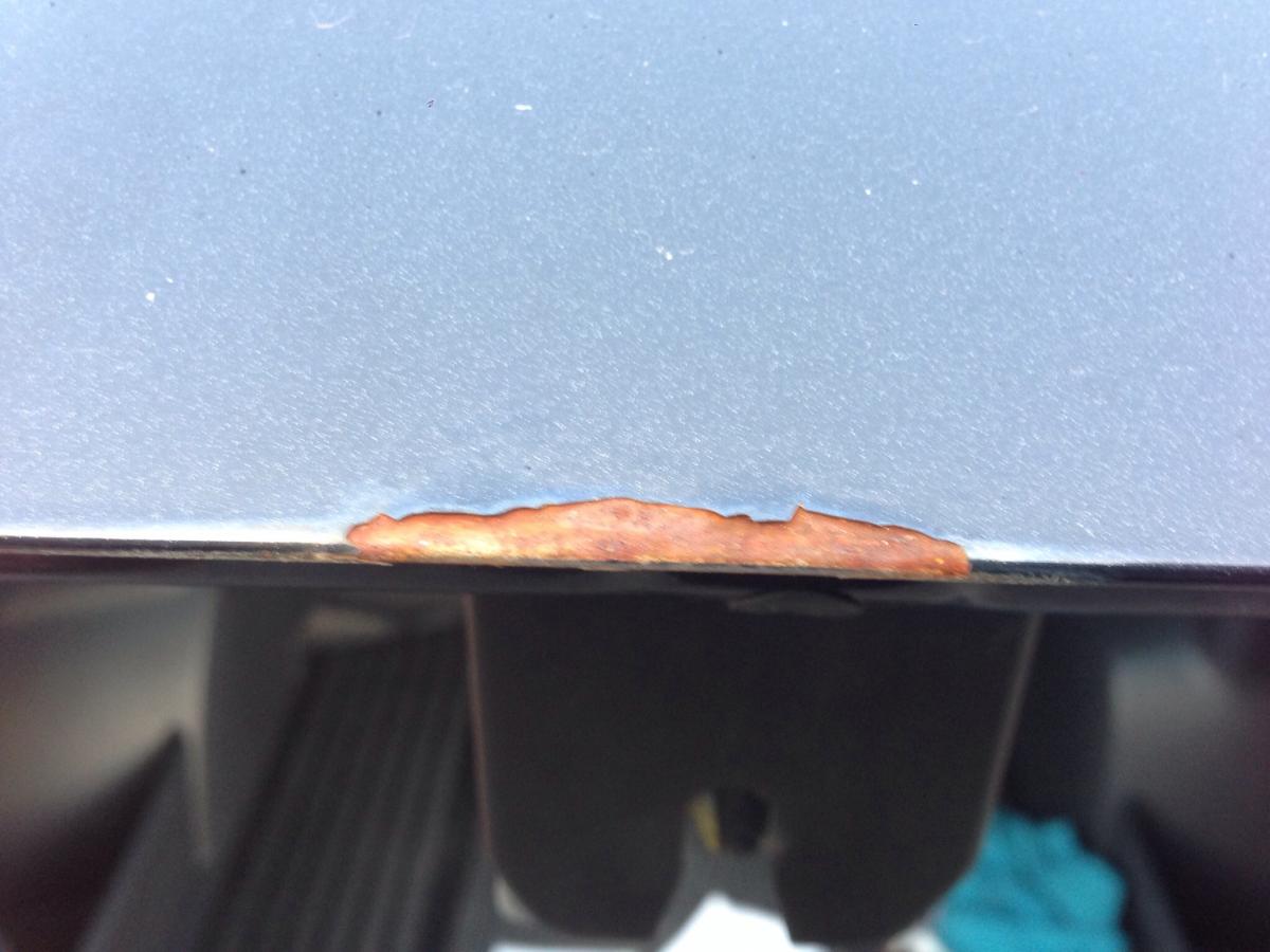

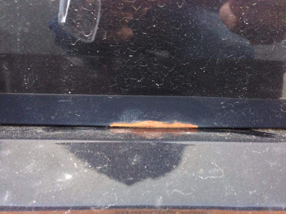

Couple of pictures of rust spot. It's right at the bottom of the tailgate half way across. It's also worked it's way inside too :-(
Looks to me like the tailgate is touching the bumper cover.
If it is then the bumper may need to come off to find out why.
It could have had a small bump on the rear but if it is touching and you just paint it it will soon come back.
As you don't know what you are doing with paint take it to a bodyshop.
