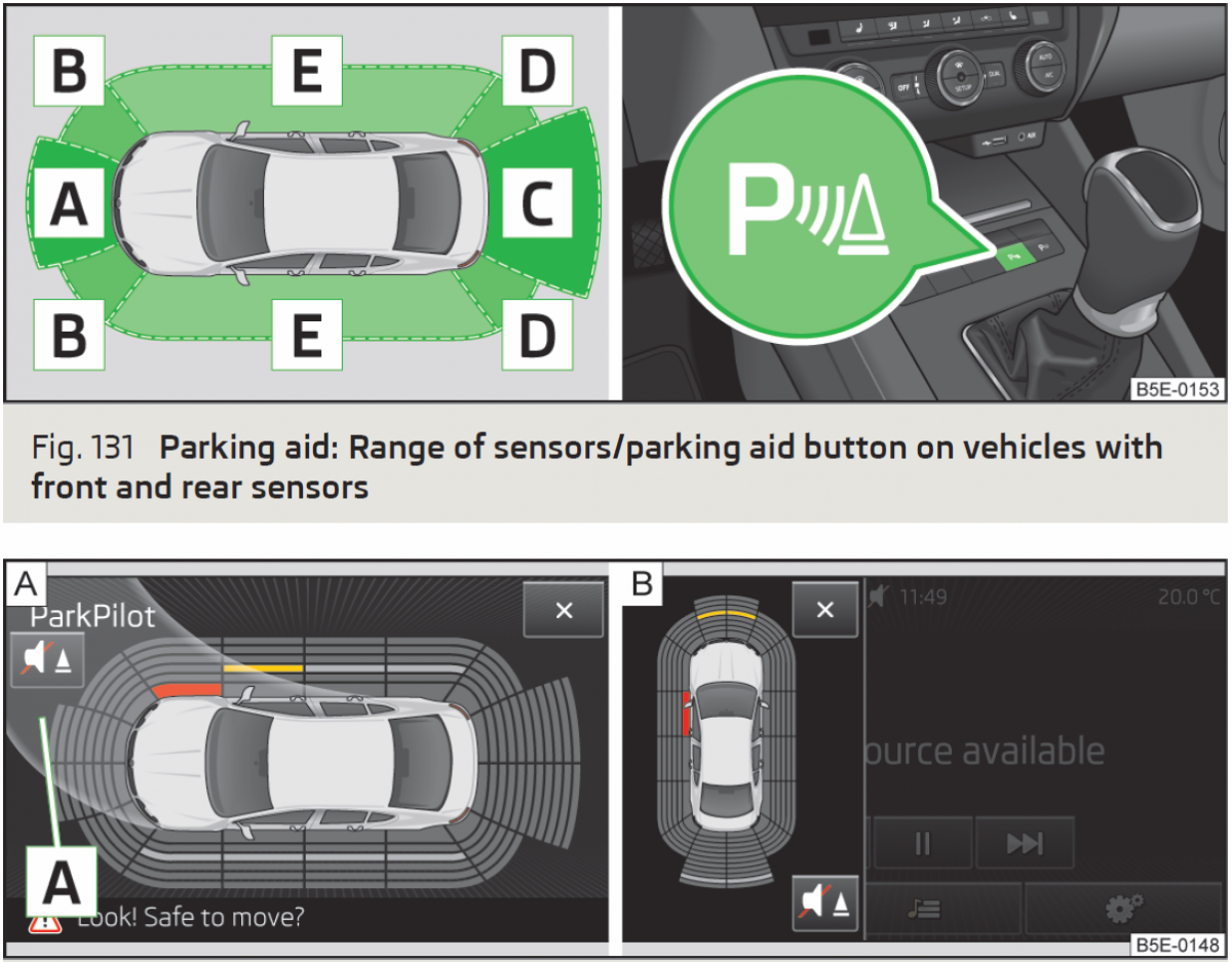

I have parking assistant on my new vRS, I have noticed over the last few days that the parking aid front sensors seem to be turn themselves off without me knowing.
Normally the light is on to show it is active, I have had it several times when I have been pulling into my parking space at work, or into my drive and the front sensors haven't bleeped or the car display doesn't appear on the Columbus, if I then press the parking aid button, I then get the bleeps and the yellow & red indicators appear on the screen.
Looking in the parking assistant section in the Car menu the sensors are set to automatic.

Not sure if the Octy is the same set up the same as a Golf but I have Park Assist and without PA selected my Front and Side sensors are active all the time below 5mph I believe - handy when driving into my garage or a parking space - but I do not have a permanent light to show they are active only the Nav screen display showing where the obstacle is and how close, and the rears only work when reverse is selected.

PA and the graphic will turn on automatically when object is close enough.
Octavia5 is correct they are supposed to be on all the time at speeds below 10 mph, I can be at the traffic lights and a car pulls up alongside side me and the screen shows the car with yellow lines down it to show they are too Bl00dy close.

Here is an example: I am pulling into my parking space at work, the front sensors come on to show me how close I am to the wall in front of me, I have had my car my car since the 9/06/2014 and they have been working correctly but the last few days this isn't happening, I am having to press the parking aid button for this happen, they aren't coming on automatically like they are supposed to, also bear in mind I am only pulling into the space at about 2mph so I am not going too quickly.

It is for all sensors including the front, activation automatically. Did you ordered only the front sensor option not the park assist?
