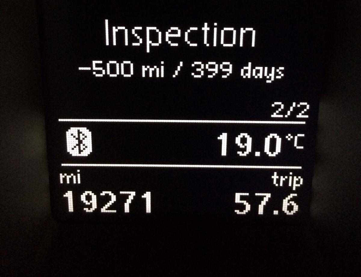

Every time I start my car I get an 'Inspection now!' message, even though it isn't due a service for thousands of miles. I've been through the instrument cluster with VCDS and can't find a way to clear it.
My pre FL never showed this message, just the distance to service counter. Both cars have the CFGB engine.
Any clues??
After a bit more poking around.....
17 - instruments - adaptation - channel 'FIX: distance covered since last mileage dependant inspection' set this to 0km and hit 'do it!'
Inspection is now reset and hasn't affected the miles to oil change service indicator.

Tried this today on mine
Didnt work but setting days since last inspection to 0 in vcds as above did. Thanks for the pointer
