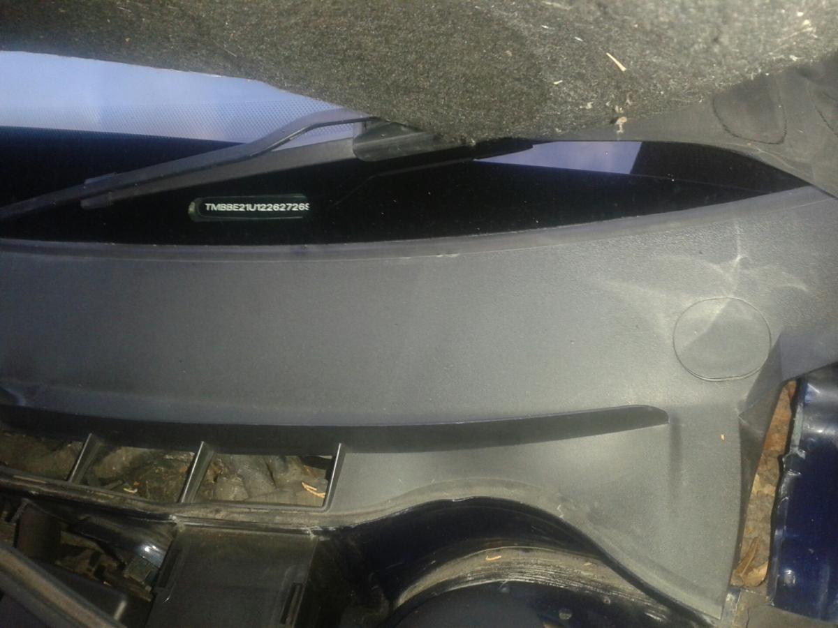

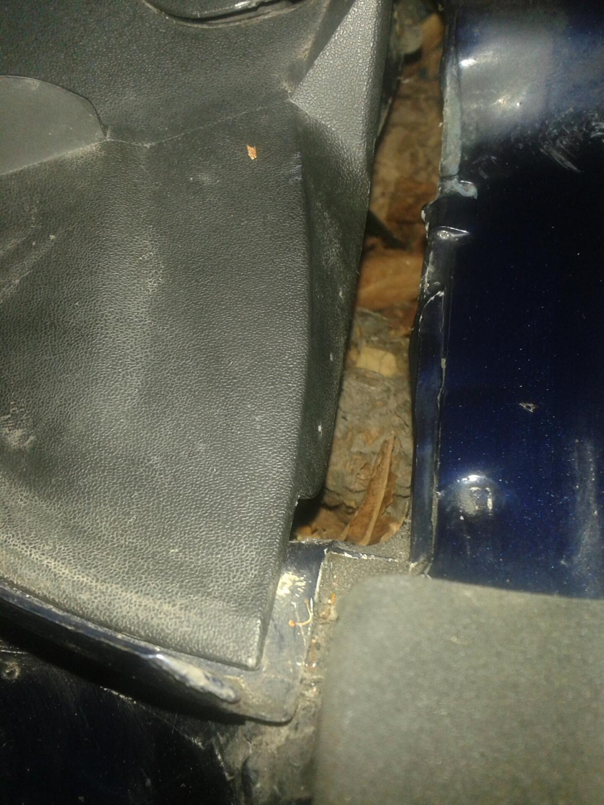

Eventually got to mine today! Was a bit tricky but second time should be a doddle.
I found birds nests, rats nests and 10 years of autumn leaves in there! Cleaned out all the dirt from the grooves.
Frustrating part was that the full service I paid for was a change of the pollen filter. Yes they changed it but didn't bother cleaning out any of the leaves!
Can't you get any mechanics to do a job properly these days? Just took a vacuum cleaner.
