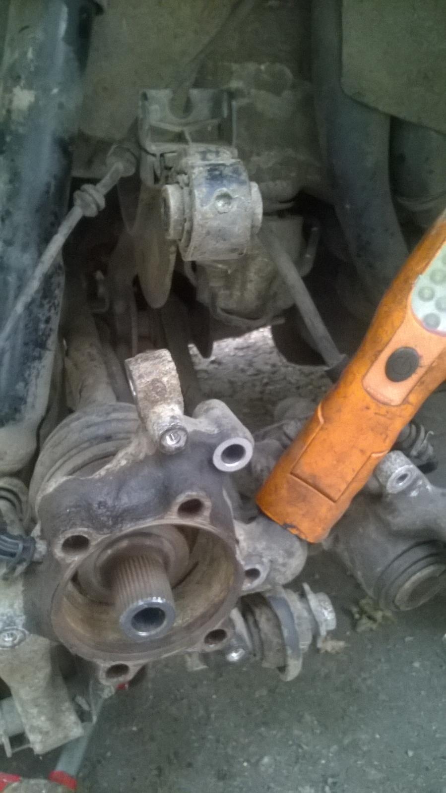

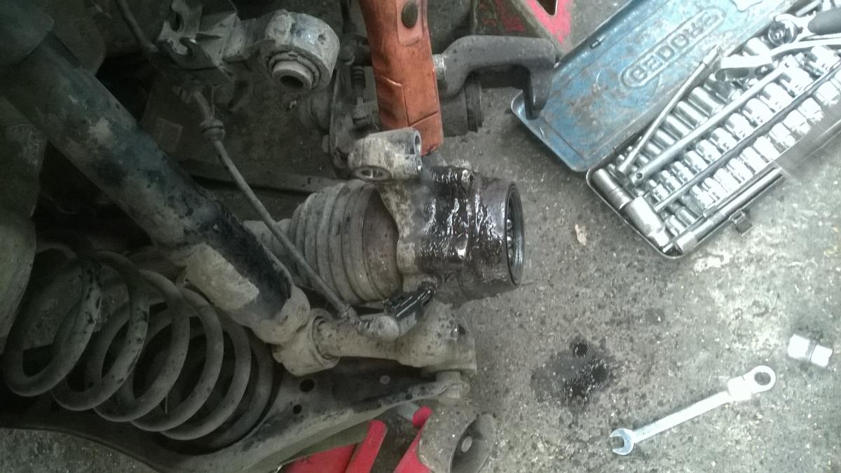

Did the job today, not so easy on a 4x4 as the shaft gets in the way of the spanner to remove the hub, we overcome this by undoing the top mount and pulling the stub outwards until we had enough clearance.

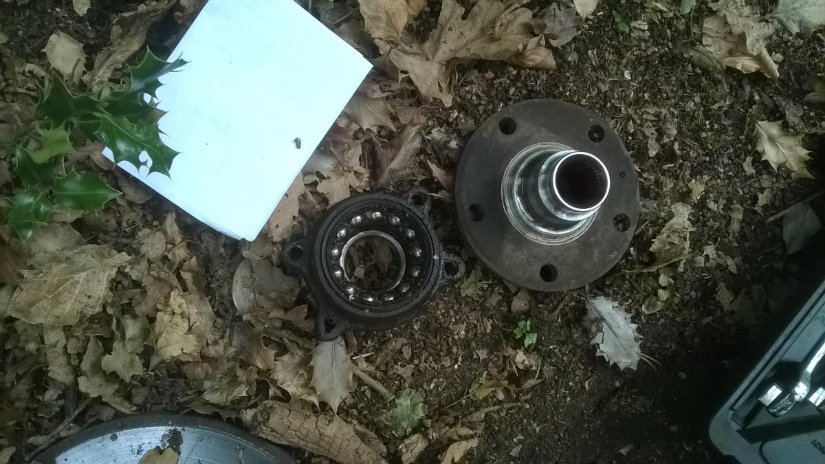

A lot quieter now with new hub, the old one fell apart when we took it out, looked like water ingress.

post-115536-0-45982400-1409009574_thumb.jpgpost-115536-0-21027500-1409009613_thumb.jpg
See if this works!
Strangely it was the off side!
It started making a humming sound and very slowly got worse, no play at all but just this noise that got louder the faster I went!
As you can see the bearings fell apart when we took the hub off, glad I did this before heading for Scotland tomorrow!
The wet on the hub is easing oil, that took a bit of hammering off, moved it round a bit then got a chisel in there! Sand paper was used to clean it out before replacing.
