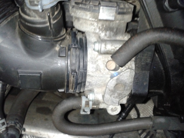

Look at the throttle body. Thought it might be on here. Mystery continues.

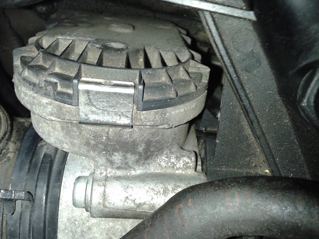

Is this the MAP in the 2nd picture?
