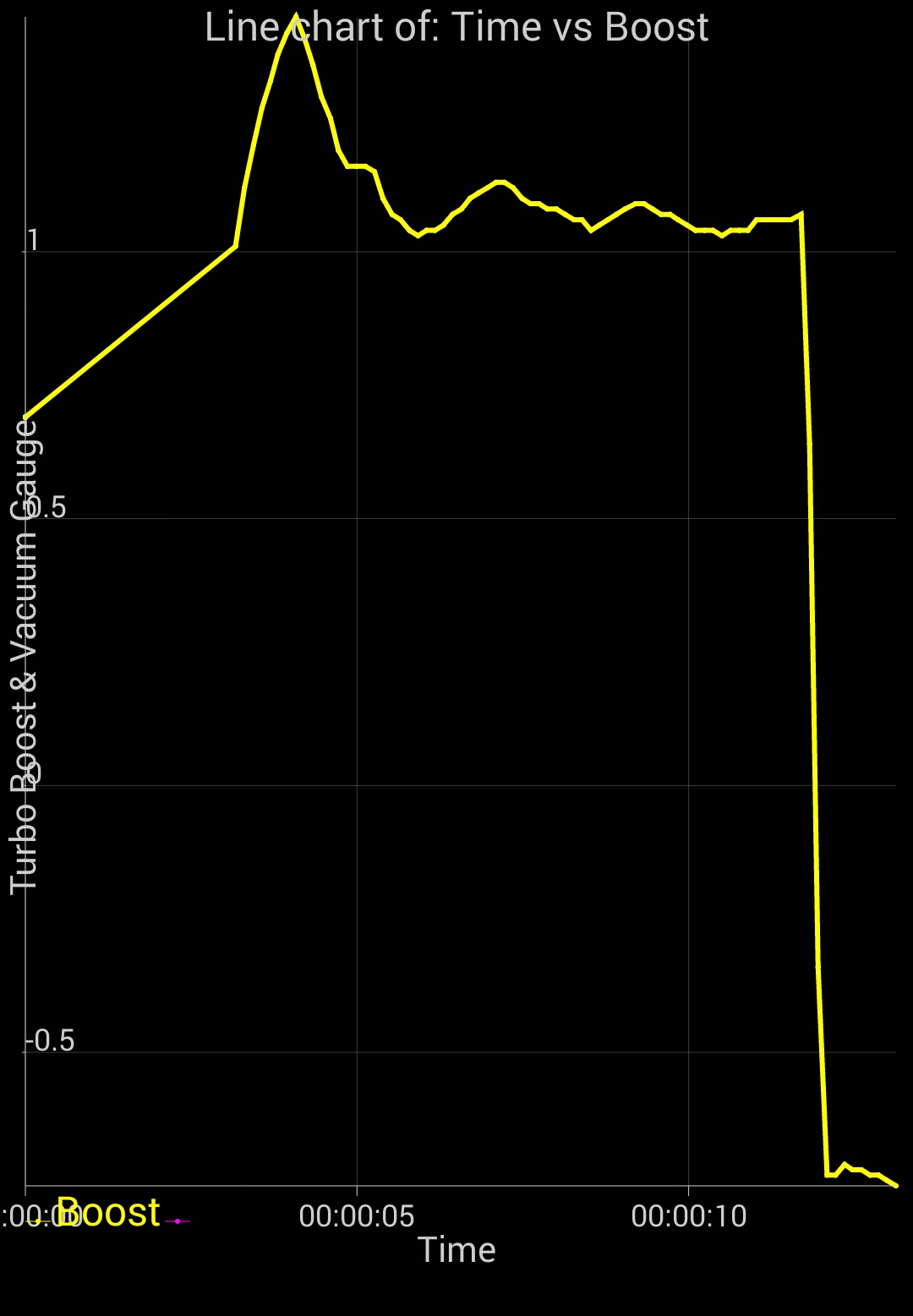

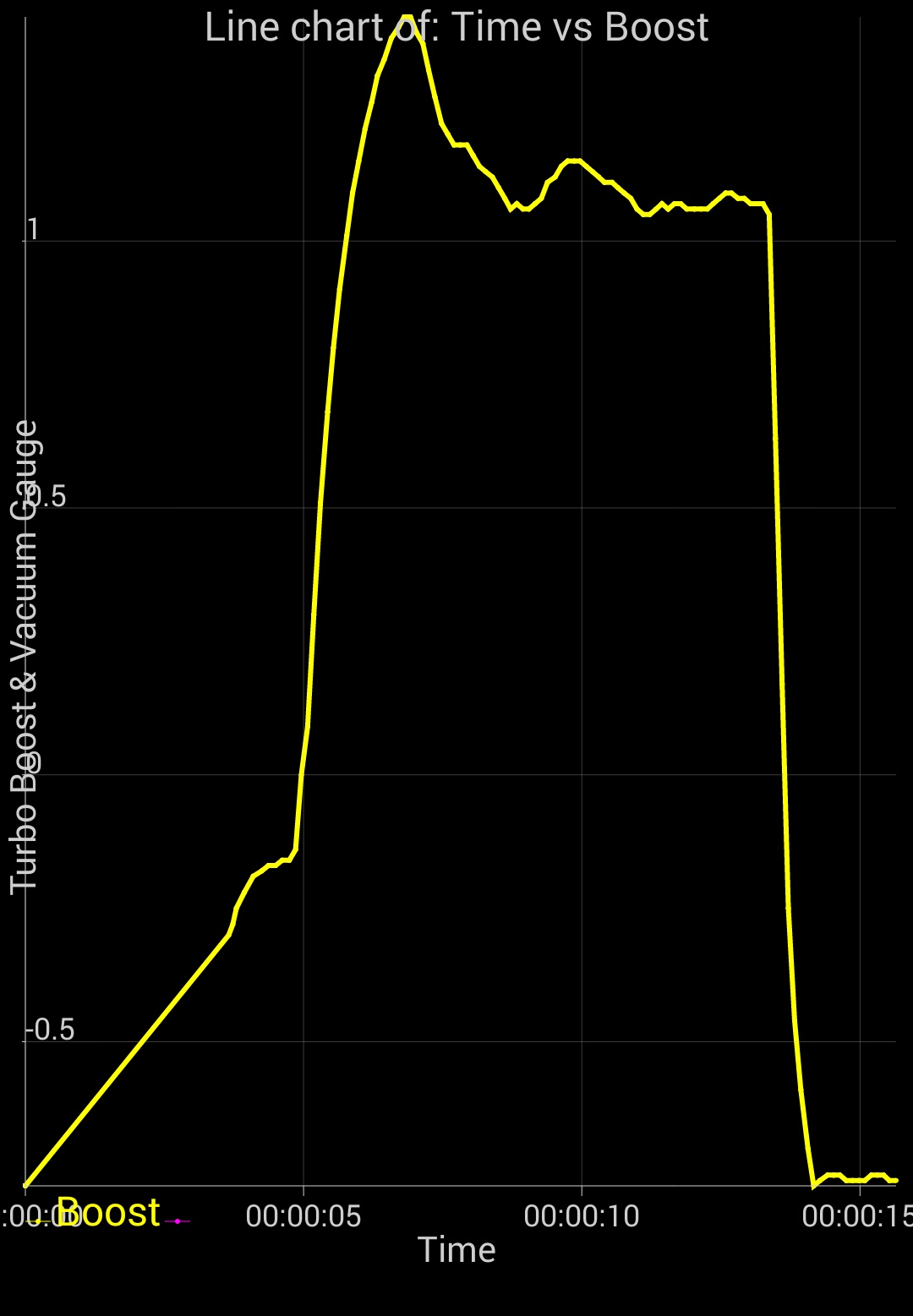

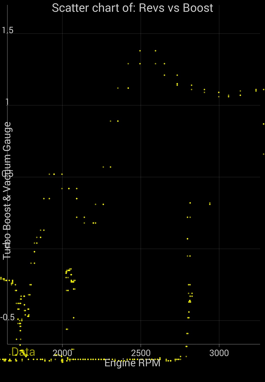

So finally got on OBD2 reader from flea-bay to check the fault codes using the Torque app on my phone. And it came up with... Nothing. Not a single fault code stored apparently. Now I'm assuming I would get full access to any faults, but maybe there are some that only vagcom can see?
Anyway, I went for a drive to keep an eye on boost pressure while driving. I hadn't changed the units so it was in In/Mercury and not bar or psi. I found I had the peak boost of 20ish (shown as max in photo) up to about 2.5k rpm and when turbo started kicking in it dropped to around 15-16. Not sure of this is normal but I thought it would be going up rather than down.
Any thoughts?
That is perfectly normal. Peak boost is when both supercharger and turbo are spinning. When supercharger disengages boost drops but with more revs it is still flowing enough air. In my under certain circumstances I can very clearly feel substantial boost kick at 5krpm where the turbo hits its sweet spot.

Hopefully the pics upload this time. I don't get any peak at around 5k. The peak is when you put your foot down till about 2.5-3k rpm and then drops off to a steady value

Thanks for the reply George. No I'm not using super unleaded as I can't get it. The point is I haven't changed fuels, always been using e5 or standard 95, but I still think it's not as good as it was before.
It's not so much the torque values I'm worried about, but that in turbo only mode the boost isn't as high as it should be. I need to do a bit more testing to see if I'm getting a drop after s/c cutout or if it's just wastegate preventing over boost.

It is not increasing boost pressure at 5k rpm, just the compressor wheel hits it's sweet spot for efficiency.
