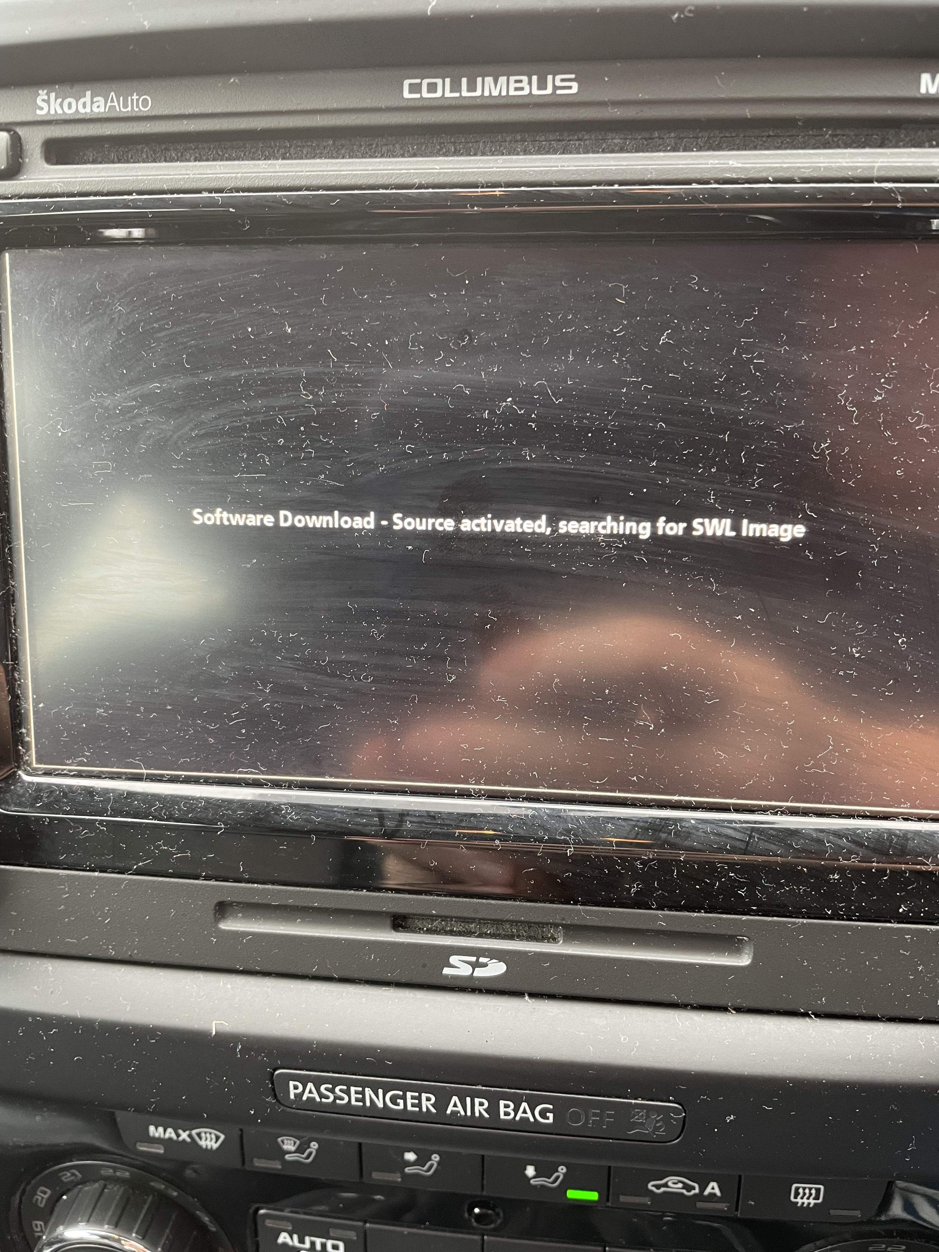

Following a flat battery over Xmas and replacing with a brand new battery, my system is displaying the following message - Software Download-Source activated, searching for SWL Image.
Can't knock it off and back on so have had to resort to disconnecting it as its draining the new battery. Skoda main dealer has looked at it and told me that the head unit has gone. Is it repairable or any advice on the best places to replace it please?

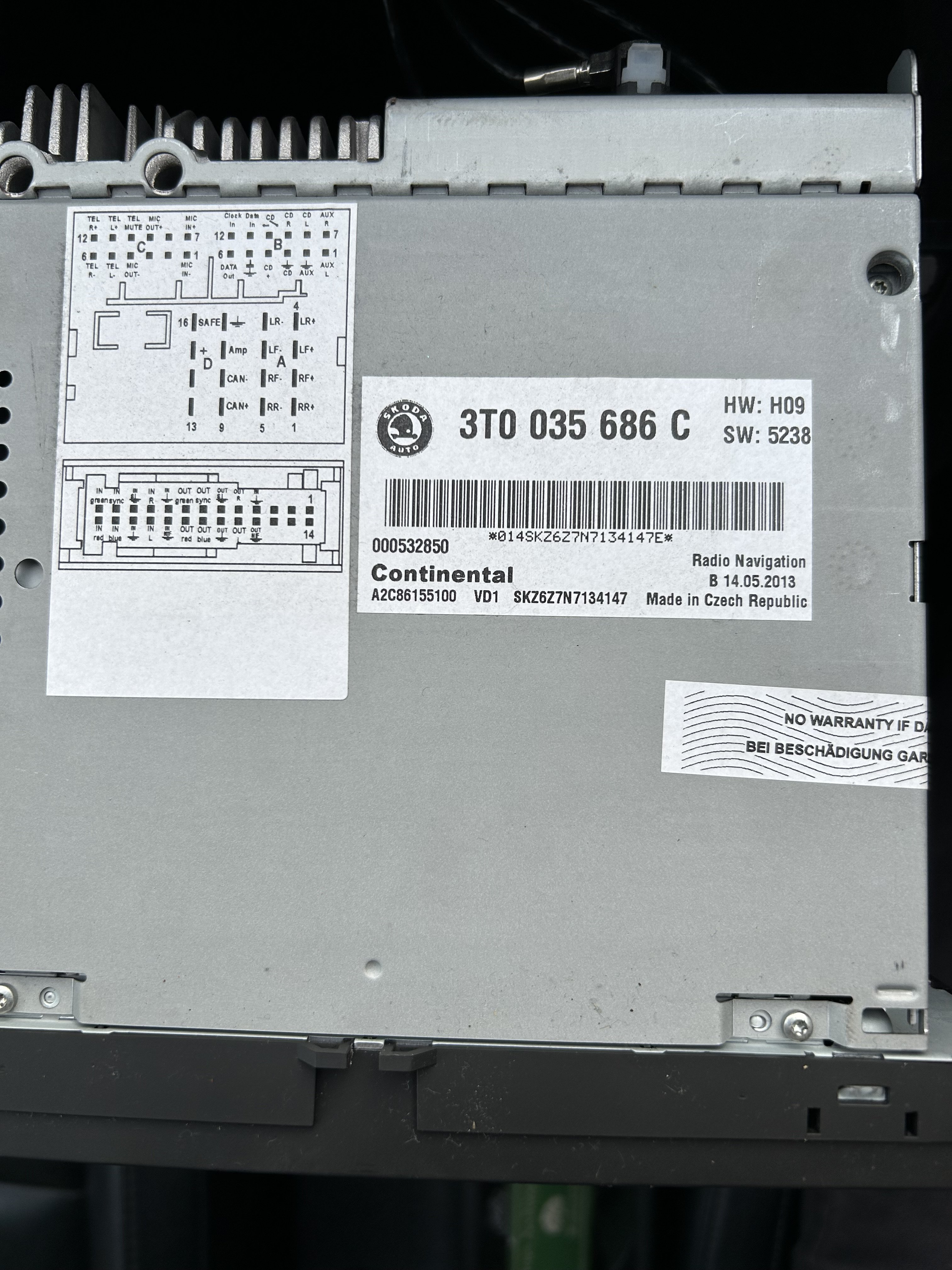

  • It's looking for CD with SW upgrade. Take the unit out and post a picture of upper case label.

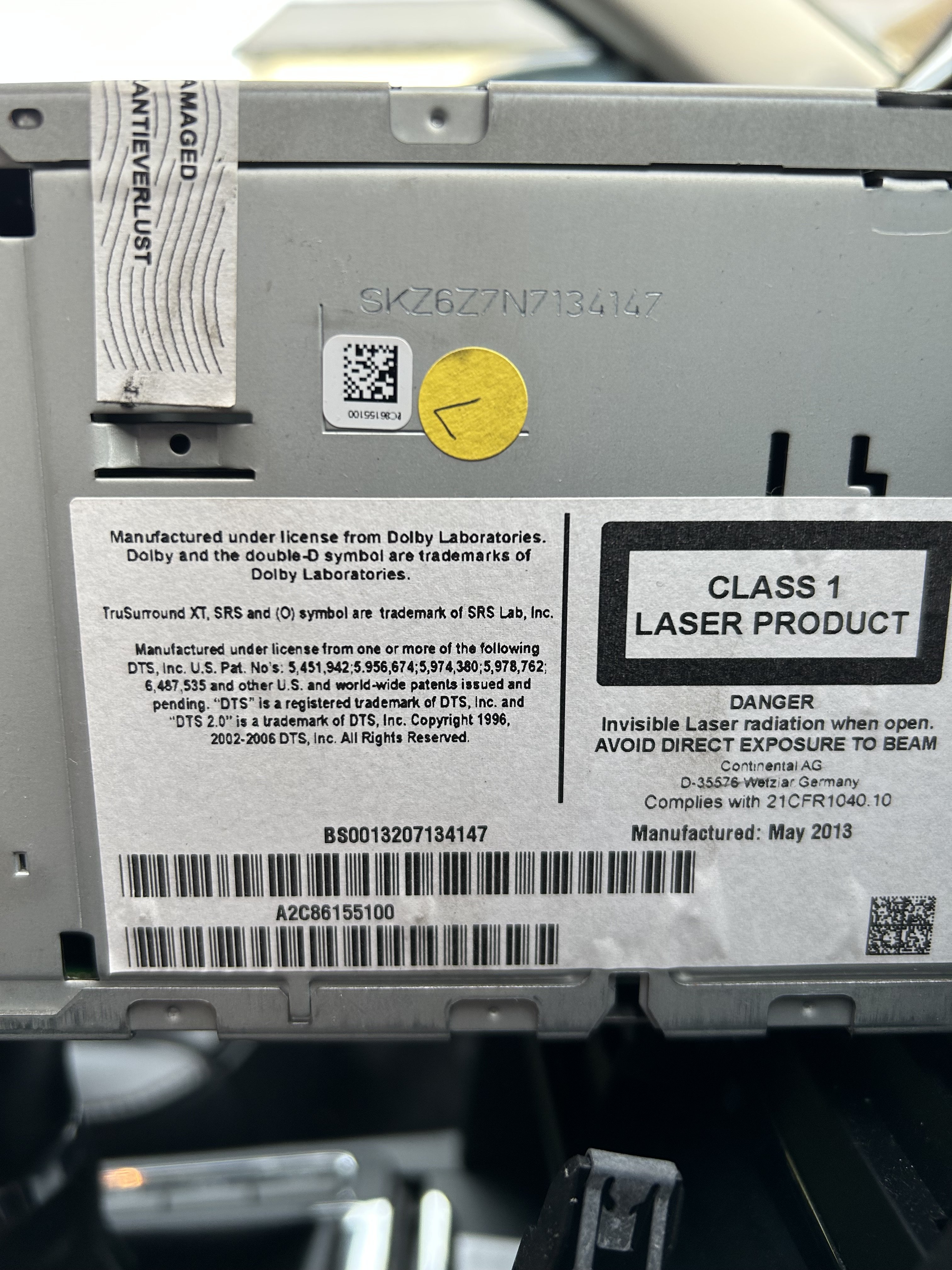

Photos of the top, side and the message on the screen

It's not "frozen" it's waiting to be fed with a firmware CD, and then it will take over the boot code and the buttons should work.
Ok, you have this value on your image 3T0035686C, which you can see in the following and the firmware matches with 5238
RNS510 SW5238

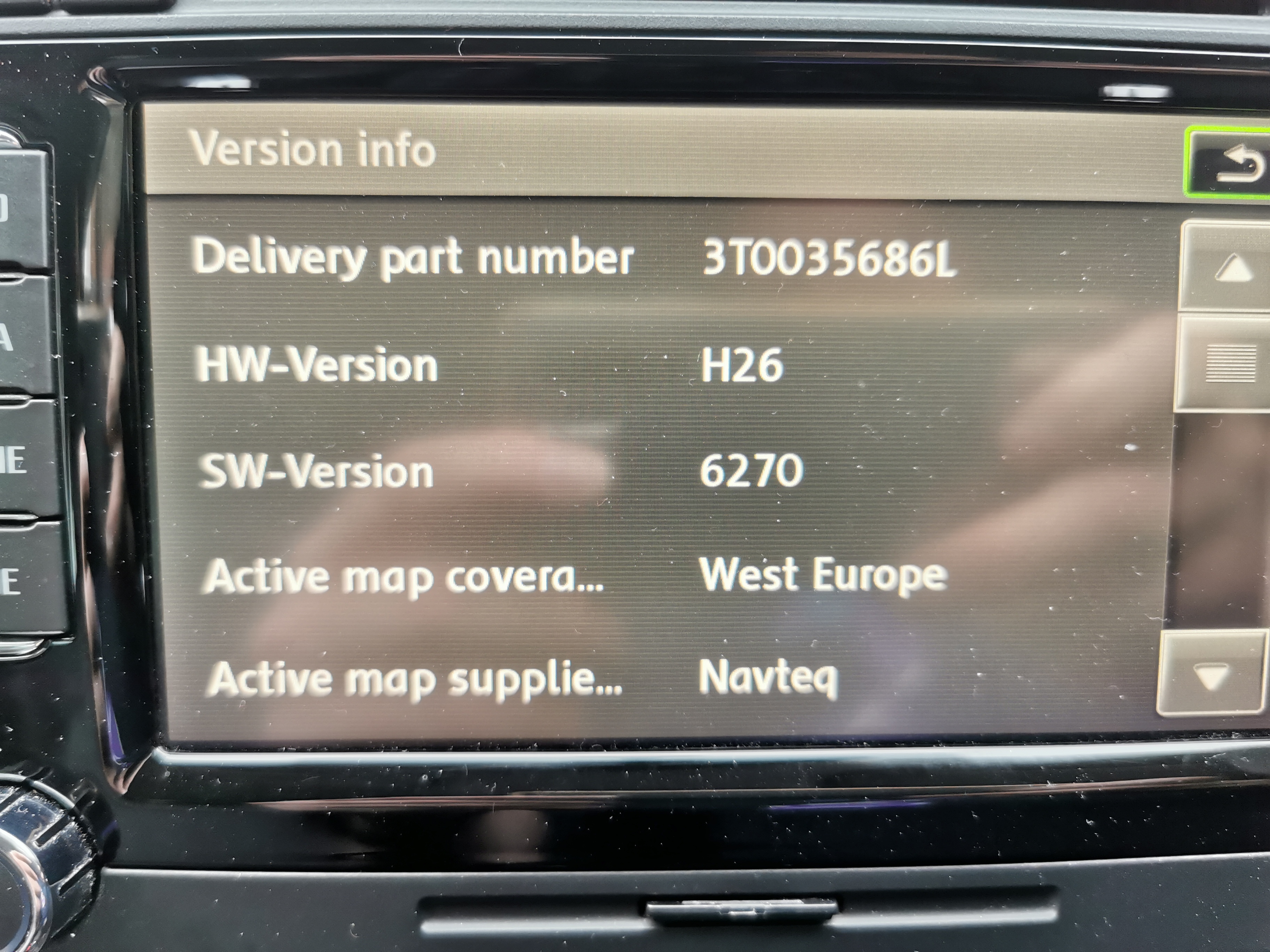

Sorry to jump on this post. My columbus is occasionally shutting down then restarting I am told it make need this update disk.
Would one of you kind gents be able to email me something?
Below or attached is what the car says I have

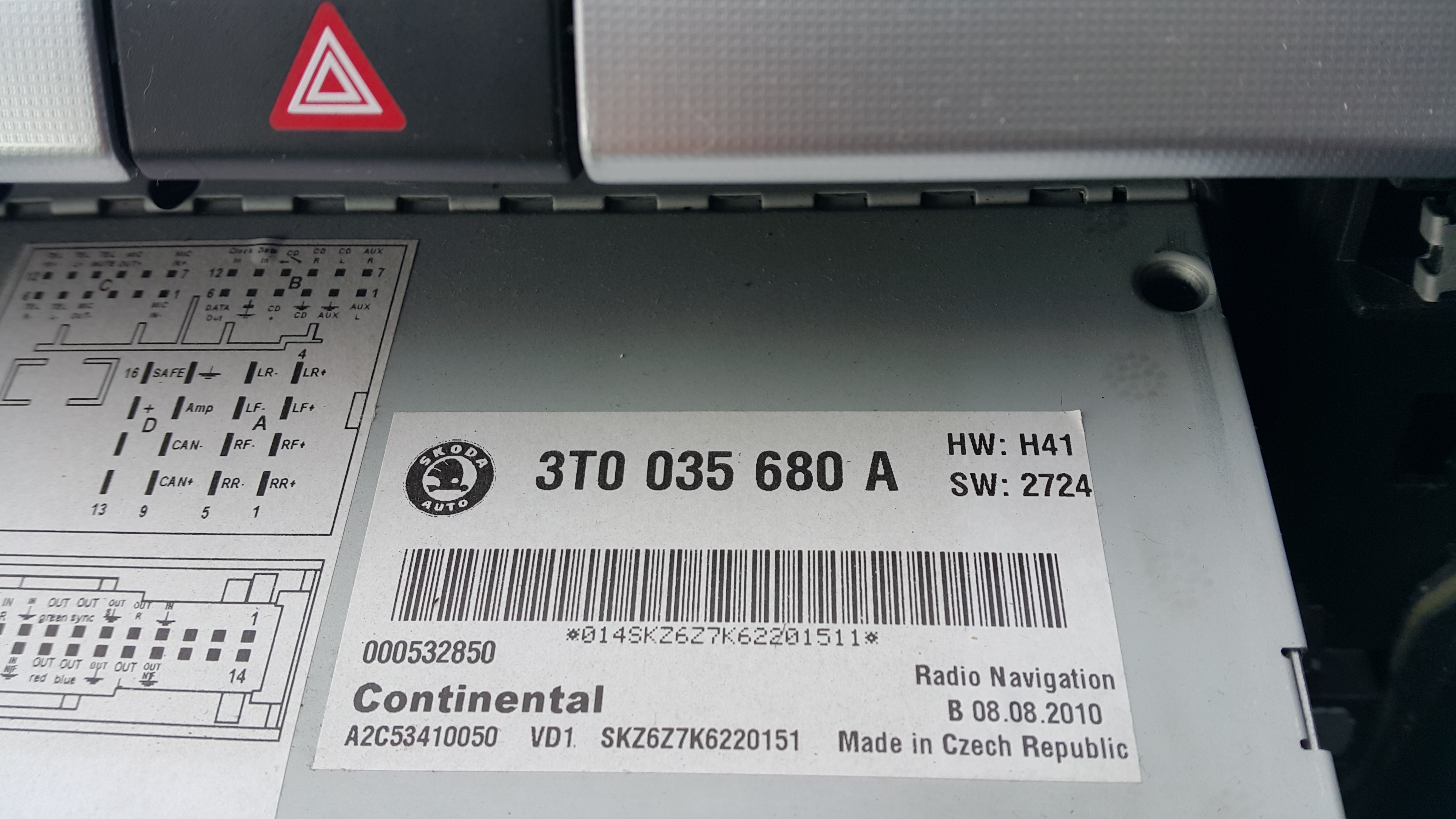

 also asking, as I have similar problems if I may PM you good gents for the corect upgrade version number please? Here is my removed unit. Thanks
